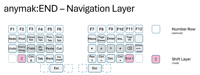

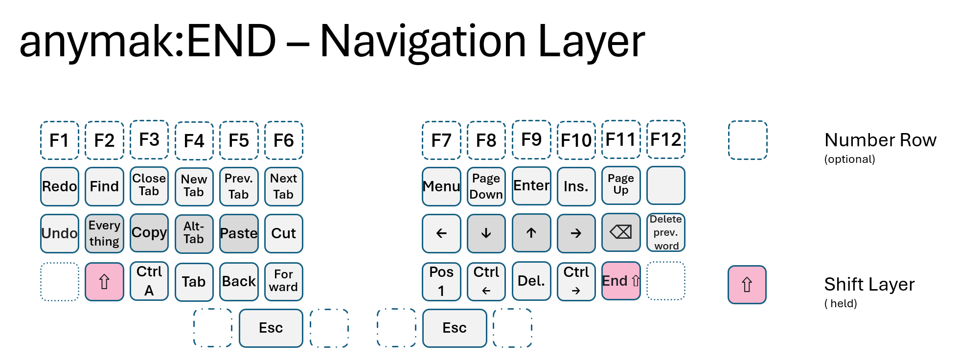

This is my MOD layer (Space-key held triggers MOD). The UHK has more keys, but I have the same 4x6 matrix on the UHK, although it looks a tad different due the row stagger.

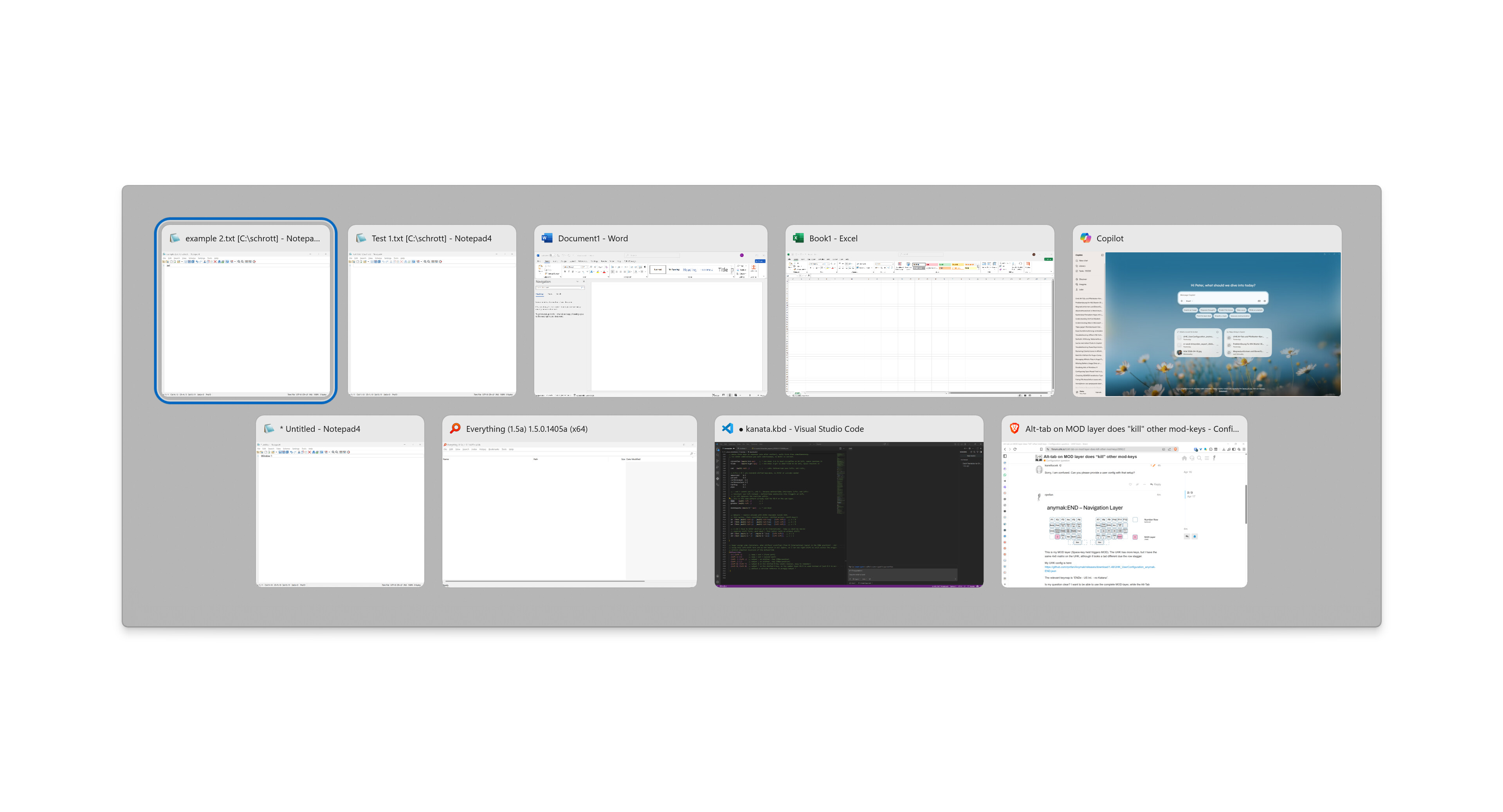

Is my question clear? I want to be able to use the complete MOD-layer, while the Alt-Tab overview is still visible (space-key still held). This allows me to interact with the tabs, very handy if I have many windows are open. That is such a convenient way to close programs or navigate to the wanted window.
