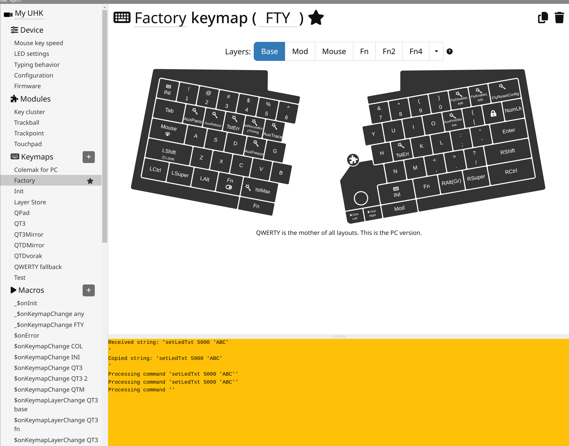

(Everything below is using the stock configuration that Agent provides when clicking “Reset device configuration.”)
Following your instructions and running exactly one uhkcmd, I get the same as you:
Received string: 'setLedTxt 5000 ABC
Copied string: 'setLedTxt 5000 ABC
Processing command 'setLedTxt 5000 ABC'
Processing command ''
And I know you said only one uhkcmd…but just in case, here’s what happens when I do uhkcmd setLedTxt 500 ABC; sleep 1; uhkcmd noOp:

Curiously enough, if I change 500 to 5000, no such error happens. It’s like the no-op was never received.
5000 + noOp => no error
