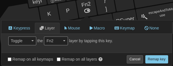

What does the toggle on the key mean here please?
It means toggle layer.
