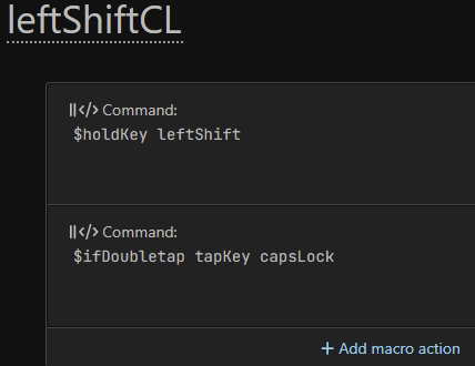

Not sure if the last answer worked, but I’ve been doing this for ages using this macro. It’s not as cool as the spiffy code lol, but it does exactly what you describe you want to do:

Btw, @UHQueefboard , you can write both commands into a single </> Command entry box. Is there a reason why you kept them separate?
Legacy from my initial learning lol
Followed by adherence to the principle of “if it’s working, don’t touch it”
But yeah I should go thru and condense all the commands I have split.
