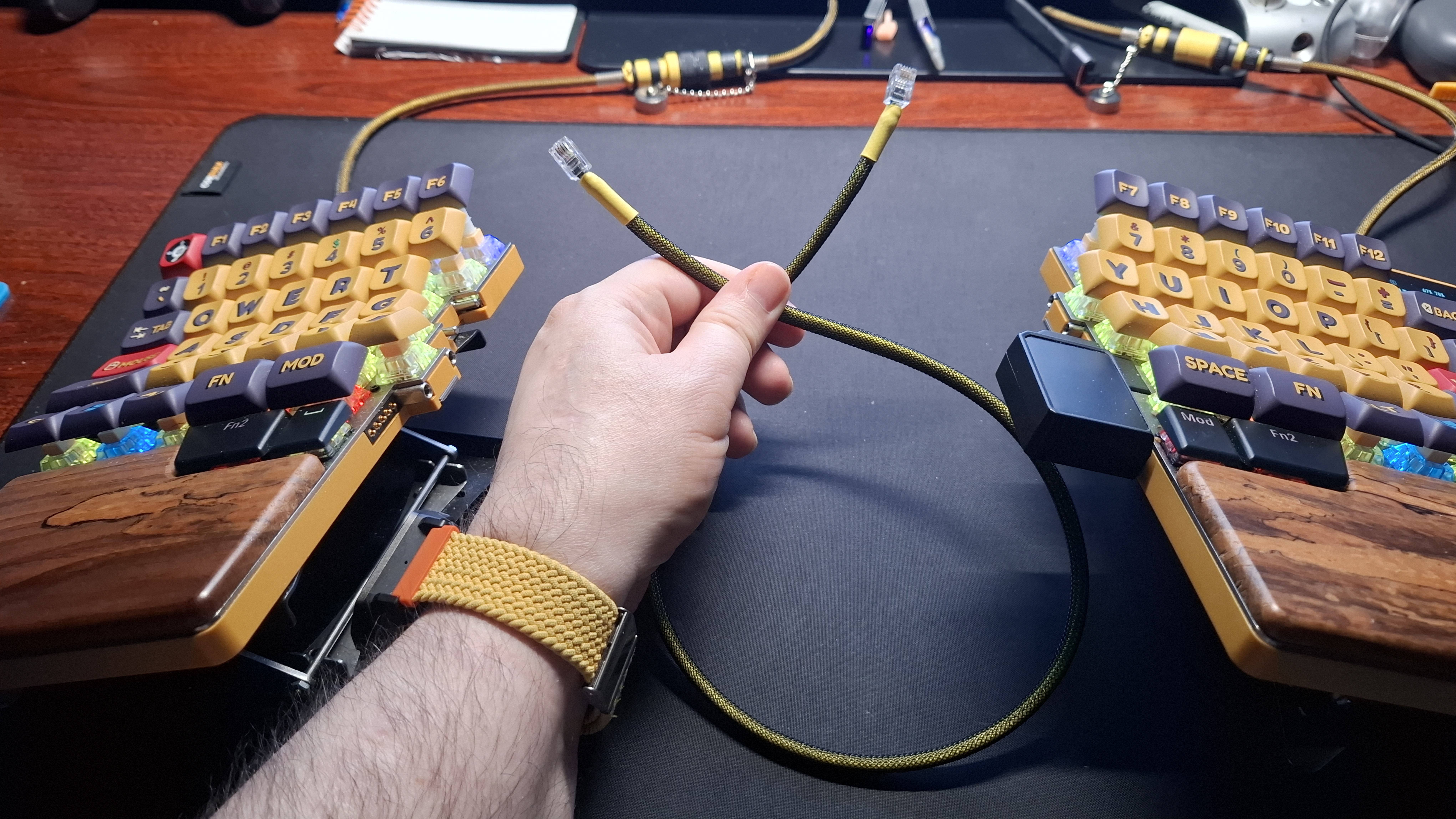

It may be easier (but kinda pricey) to make your own. Just snip one end off of a straight-through wired cable & slap on a new connector in reverse. I have a huge roll of telephone cable and some 4P4C connectors, so I just terminate my own cables for both the UHK60 and UHK80. I also sleeve them with some paracord & tecflex to color match my devices.:smiling_face_with_sunglasses:

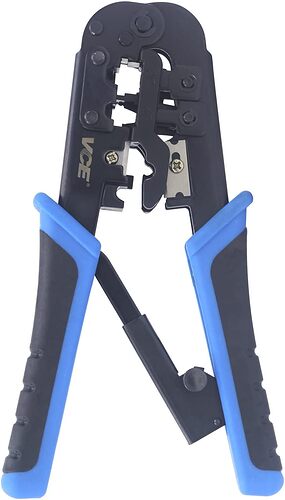

Anyway, you could make a handful of cables yourself for under $50. You don’t really even need the crimper tool, it just makes it easier.

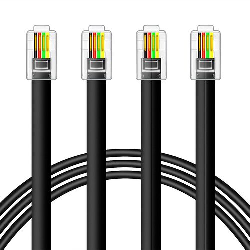

Straight-through Cables:

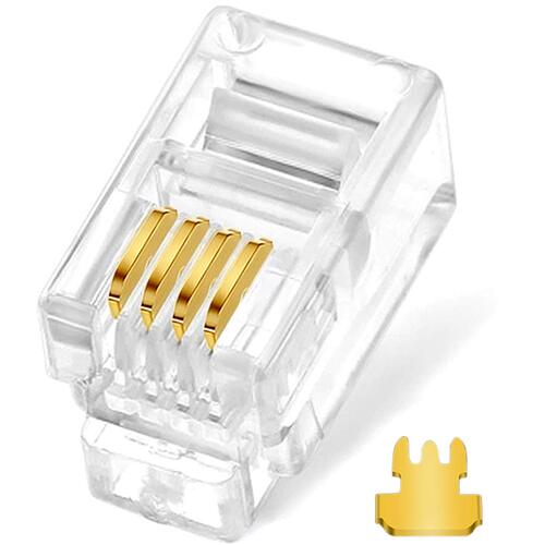

4P4C Connectors:
Crimper Tool:
