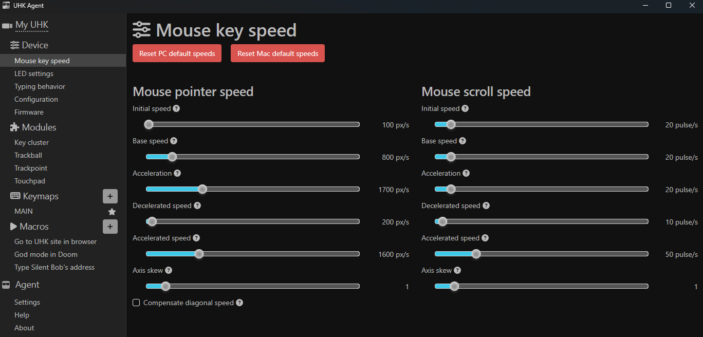

I have this weird issue that I’m sure is a good explanation to. I cannot figure it out though. It’s 3 week old 60 v2.
When I start my PC, the keyboard always have some issue with the scrolling speed using the keyboard. It scrolls insanely slow. I have to restart the PC or re-plug the keyboard for it to go back to the actual expected speed. My settings are unchanged during this buggy phase vs. re-plugging or restarting.
Settings for reference:
Anyone experienced something similar?
