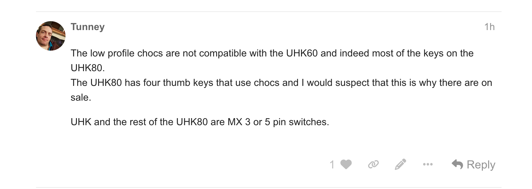

They won’t fit.
but it says they are for the uhk!?
The UHK 80 has regular MX switches (most of the keyboard) and “Choc v2” switches (the front row thumb keys which are lower than the rest of the keyboard). The UHK 60 has only regular MX switches (and case buttons, but those cannot be swapped).
These two types of switches (MX, Choc) are mutually incompatible. They won’t fit the other socket. Their pins sit at different positions, and the centre pin has a different diameter. When you order switches you need to make sure you order the type that you want to fit into your keyboard.
Oh wow I didn’t knew the 80 had different switches. So it is safe to say that low profile switches will not fit the 60 in any way?
The Kailh low profiles will 100% not fit.
