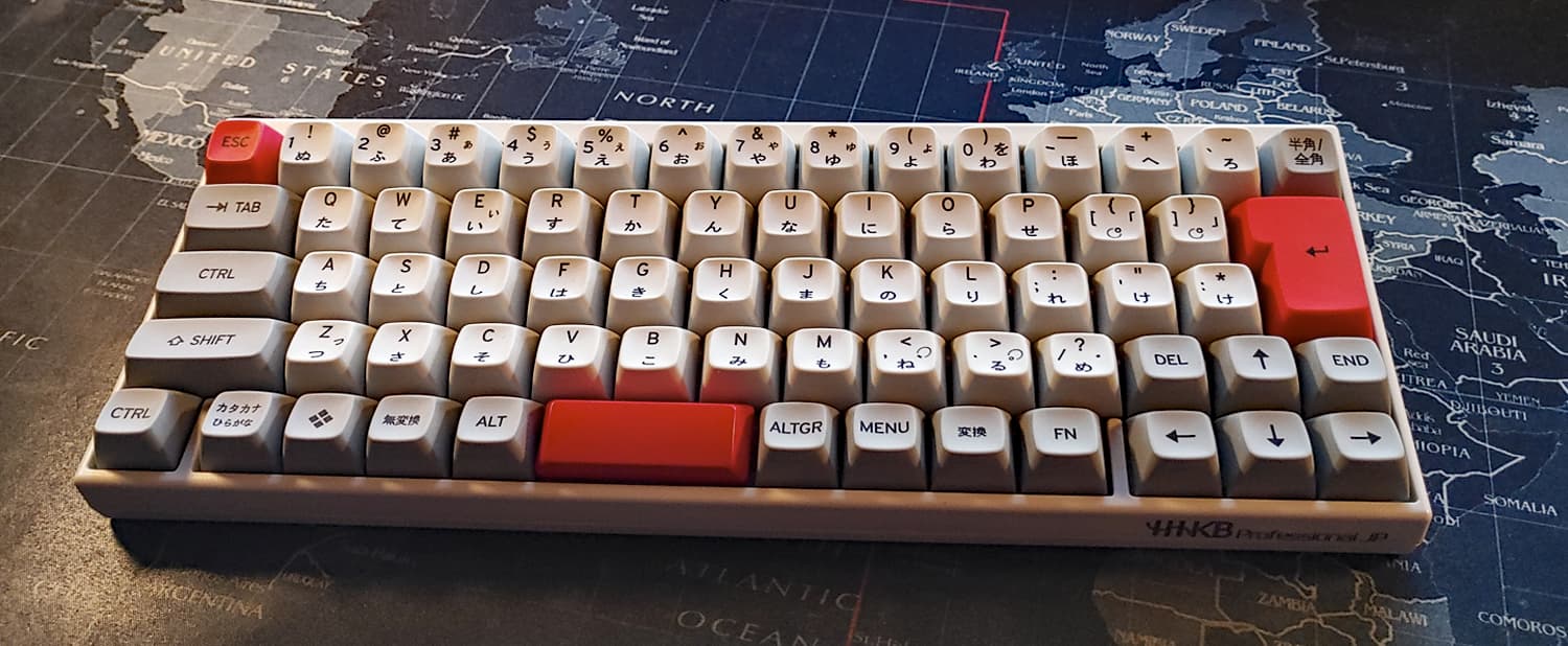

The main reason might be my love for Topre and the JIS-Layout, my main “heavy-typing-tool” for more than 10 years is the HHKB JP, where that row is although shifted.
Have a nice day.
That’s funny. It has an ISO enter but no ISO key between left shift and Z. Kind of reverse of the ISO layout of UHK. :laughing:
:thinking:
I can relate to that. :grinning_face_with_smiling_eyes:
Japanese folks might answer, who is ISO, that’s an JIS enter.
I prefer ANSI to ISO, but that large enter is the only one I’m missing, would prefer to have.

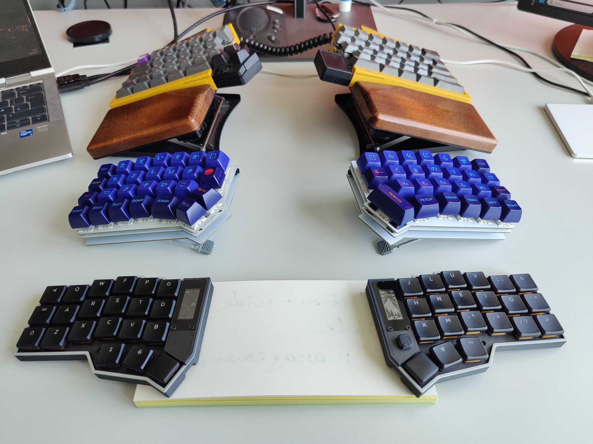

Now I got used to the ANSI Enter on the UHK and on most of my Laptops. And when you look at the Ergo (columnar stagger) boards in the photo above, there’s really no special key for Enter anyway.

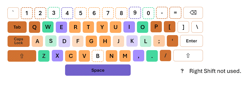

It is seldom, but here I do not agree with Max. I think another solution is objectively better in terms of ergonomics. Pressing the C-key position with the middle finger is the most awkward motion on a standard keyboard IMO. You can do it of course. I typed almost 40 years like that, but when I retrained myself (with a new layout) it become apparent that I should have done that much earlier.
Keeping the same finger positions on a columnar stagger and standard keyboard was one of the must-haves for my custom keyboard layout. I actually have explained that in detail in this article. Look for the animated pictures, which show you how the keys on a columnar stagger and standard keyboard are related. This is one of the relevant animations.
angle-mod2ergo
IMO you should indeed use the standard keyboard left side symmetrical to the right side (means pressing the c-key with the index finger). The real problem with a standard keyboard is the top left side, which you have to slightly adjust to, and will not be 100 % symmetrical on a standard keyboard. But you still can use the same fingering than on the right side. You will also find that the B-key has a special role on a standard keyboard. You just should not use it – when you want to be compatible between a 3x5 / 4x6 and a standard row stagger keyboard.

I totally understand when one does not want to do that. The question was which finger to use for the lower left row to keep the same fingering between a standard and columnar keyboard – at least that was how I understood the question. It simply is not possible to keep the fingering the same on both keyboards when using an unmodified QWERTY. One has to live either with the modification, which btw. is not that “wild”. I would move the B to the N-position and the N to the ;-position. Of course the ; needs to find a new place on the symbol layer – which makes sense in any case I think. But is especially important for non-english typists.
Re-learning a new key to come to usable speed takes about 1h of deliberate practice btw. So with about 2 or 3 hours you would be (mostly) back to speed. That is not that hard. If you want to move away from standard QUWERTY is another question of course. There are good reasons not to go that route. But then I would stay also with standard keyboard – for the mentioned reasons.

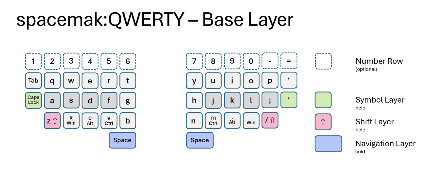

That is an option with less impact possibly, but still not 100 % compatible. In any case you can not have both (unmodified) QWERTY compatibility and at the same time same fingering on a standard and a split ergo keyboard. It was a heureka moment when it became clear to me that the B-key (position) plays a special role in that regard. BTW, of course the B-key is not “lost”, but when you look at the animation above you see a new key appearing on the left side. You could also say the B-key moves from the center to the left side. For an ISO-board I think your suggestion is a good one, for those wanting to change little. Of course that will keep Shift in the pretty bad position, which one can get accustomed too, but it is far from ergonomic. Even the B-key is better to reach – which is otherwise in the main alpha-block the worst key! You could put shift as a bottom-row-mod on the Z and ?-key. That is likely then the best “little changes” compromise and actually not bad at all!
I have described that concept in the article linked already, as well in the beginning of this article – look for the pyramid graphic there.
On Github you find a quick overview of the concept, which I call Spacemak – in honor of the SpaceFn-concept it expands upon.
I plan to create Kanata config files for possible different stages to use that concept, but do not know when I will come around to do so. But as a UHK user you can quickly create the needed configuration! :slight_smile: I just use an ergo split graphic, because it makes it much easier to see what is going on. But you can apply the same concept to a standard keyboard.

  • integrated tenting. At the moment, I place a book or a stack of notes in the middle and prop up the two halves in the middle.
