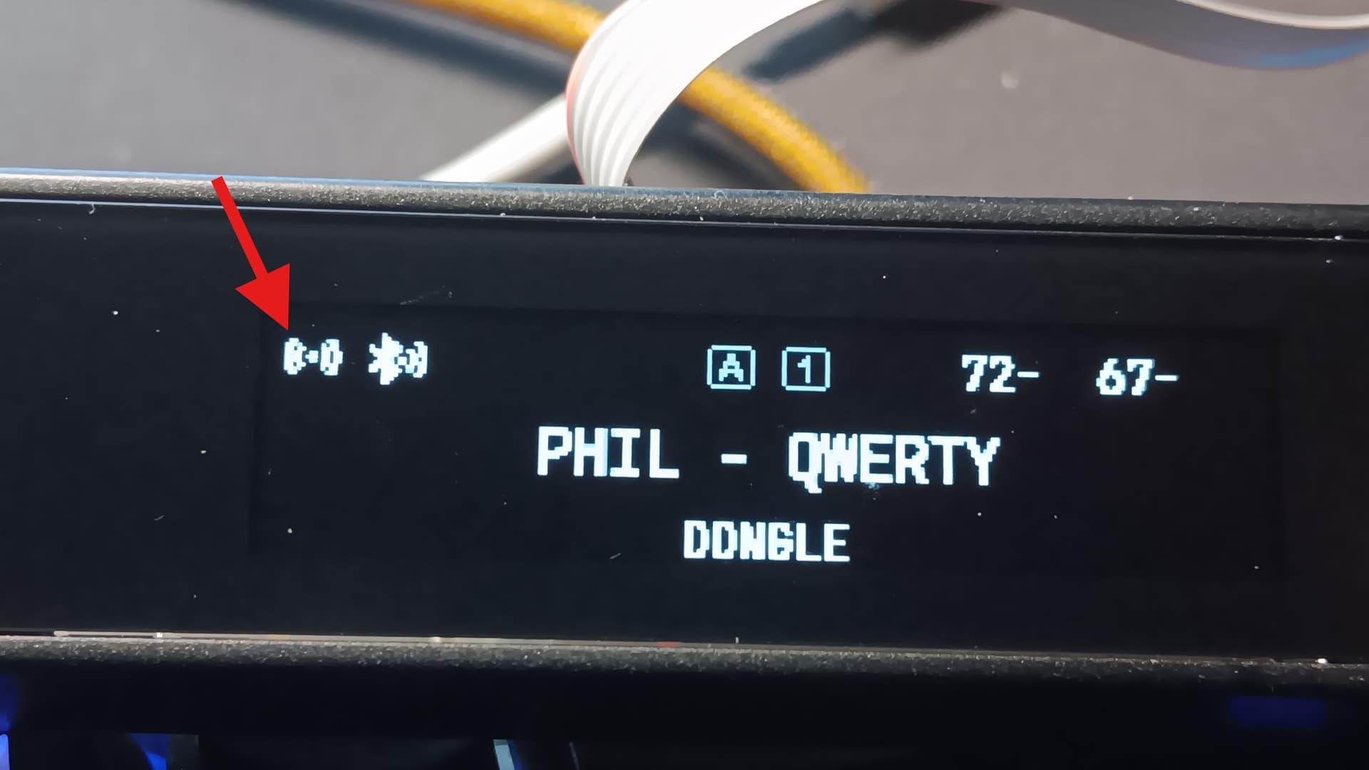

What firmware/Agent versions are you using?
It should auto-switch to wireless mode when disconnecting the bridge cable. Do you see a wireless icon, or a circle with an “X”?:

Issuing the reboot command fixed it.
