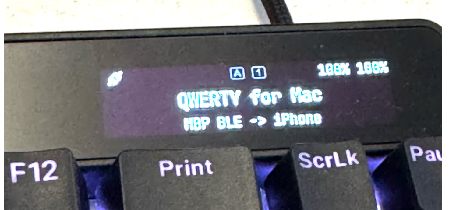

What does the “->” mean in the below?
I’m pretty sure it means it’s waiting to switch from the host on the left (currently connected host), to the host on the right (desired host connection), but the second device isn’t yet available. In the case of multiple BLE connections, you’ll need to disconnect the first device before it can switch to the next.
BLE doesn’t really work does it? Solidly and intuitively, and with multiple devices…
How do you disconnect from the first device
have tried the switchHost “name” and switchHost name
but no joy
If I am connected to my iPhone I cannot switch to the Macbook BLE stays at “->”
If I then turn off bluetooth in the iPhone, it still does the same “->”
Do I need to force a disconnect at the keyboard level?
Then when I turn back on the bluetooth on the iPhone immediately connects.
On my BLE devices, I have to disconnect on the host device itself before switching. It’s definitely not ideal, but that’s the way it is ATM (for me, at least).
Turn BT off on my iPhone does not let it connect from the MBP
Forgetting it in the iPhone does not let it connect from the MBP
Switching BLE hosts does not seem to work ![]()
Right I am giving up on the BLE, it really does not work reliably at all.
Uhk should disconnect the connection and then wait till the selected connection connects… but there is some bug as mentioned.
