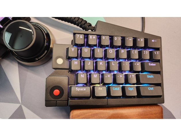

Wanted to share this model I created to incorporate TouchID into the uhk60. Uses the TouchID that can be extracted from the magic keyboard - specifically I used a lightning version since they are more readily available and can be found for cheaper, but from what I’ve seen the usb c version is the same layout, so as long as the port’s ribbon cable is the same, it should work.
It fits the right side above the official module, as close as I could get it to be as reachable as possible. Can of course just plug straight into your computer, but for minimal wires I used an anker hub that I printed a lower profile case for. Allows single wire for keeb, TouchID, and spacemouse with a port to spare - thinking maybe a second version of the touchid module with a female usbc for yubikey.
