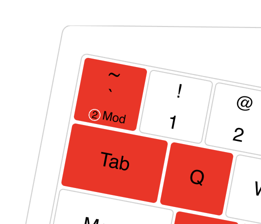

Great, but why keyboard is white in per-key mode?

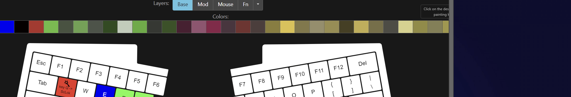

And is it possible to add some “ok/add” button when adding new color?
Also is it possible to have “black color” to disable light for specific keys? Cause currently it does not want to add such color.
And need to have edit button, cause no way to modify existing colors.
Also key color is reset on each remap but must be preserved.

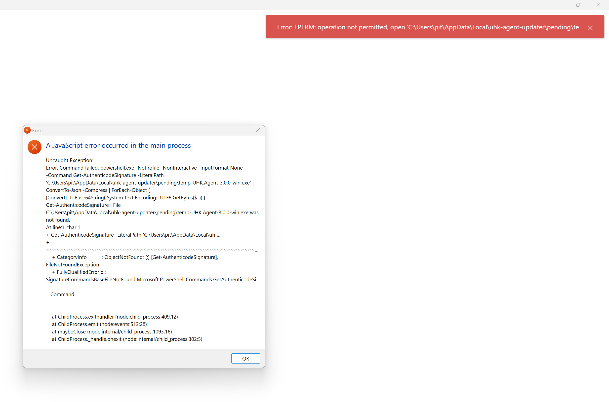

It does not for me and when I check for update I get the following error.
Manual deinstallation and installation of v3 worked fine. Also checking for update with version 3 throws no error.

If too many colors are configured then they does not fit in screen.
  • Sort of a bug is when per-key backlighting was used and the brush is still open when switching to functional backlighting one can not edit keys any longer.
  • a color assigned (per-key) can not be erased

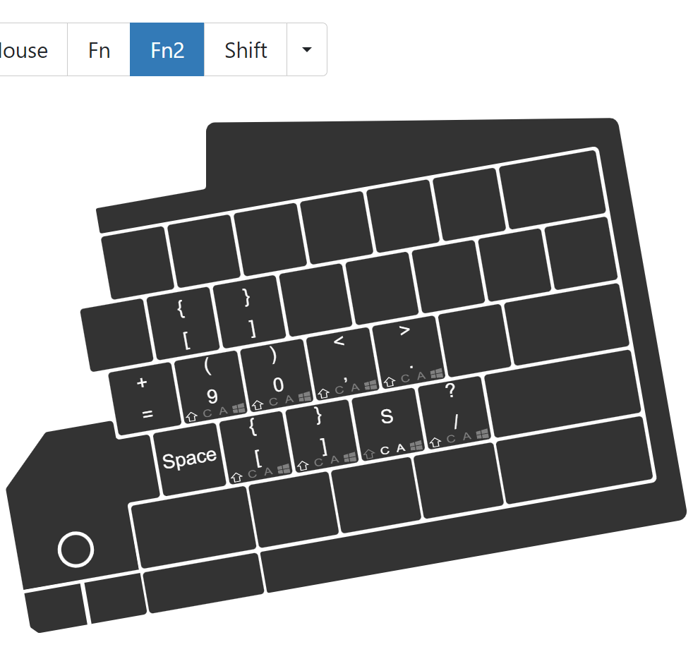

  • oneShot of a layer does not honor modifiers and also not what is defined on a modifier layer (for example the Shift layer)
Example for the first case: oneShot holdLayer fn2 will work as expected when hold, but not when tapped, for example on the m-key (qwerty) I get ] instead of }
Thanks for your reports! Please open separate Agent/firmware issues (whichever applies).
This issue has been opened so far: Per-key coloring configuration problems. · Issue #2031 · UltimateHackingKeyboard/agent · GitHub
The keyboard is white in per-key mode to make this mode trivial to differentiate from functional backlighting mode.
The circle around the “2” letter of the dual-role key should not be white anymore. This has been fixed before releasing Agent 3.0.0. Are you using a development build?

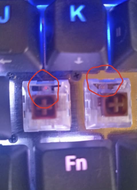

Thanks i already did it in this way but still there is an issue
that not all keys are fully “black”. For example left led still has some light.
Or here for bottom
Thus i’m not sure that rgb values set to 0 is applied correctly.
Great catch! I can reproduce this issue. It seems to me that in functional backlighting mode, unassigned keys are fully black, so this is probably a firmware issue. I’ll look into this after getting the Agent black color selection bug fixed so that I’ll be able to reproduce this issue with various keys easily.
Karel pointed out that it must be oneShot holdKey iS- because of “composition mode”(firmware/doc-dev/reference-manual.md at master · UltimateHackingKeyboard/firmware · GitHub).
