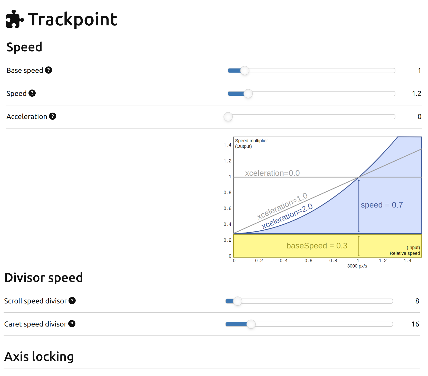

    • The speed diagram is missing entirelly from the module page. Also it may be the right time to introduce a dynamic graph that reacts to the sliders?

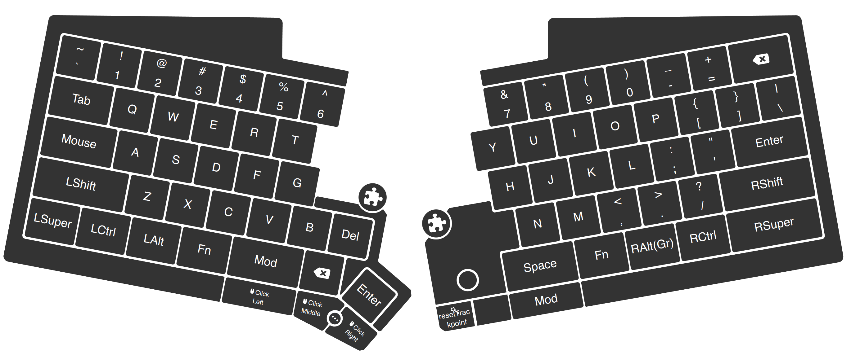

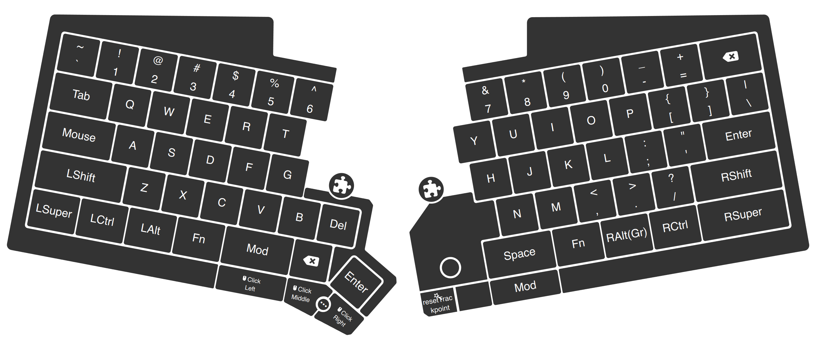

    • This looks oddly assymetric. I suggest placing the right icon farther to the right and slightly upwards:
      2024-02-29-093039_476x299_scrot
    • I find the puzzle icons to be cluttering the space. Also it is not where I would search for module config by default. I would remove them altogether and move the config pages into the left pane.

    • Suggested logarithmic scale for mouse key axis skews was ignored.

I think the puzzle icons are symmetric and useful.

Did you suggest a logarithmic scale? Where?
Here, under special behaviors: Module configuration UI · Issue #1921 · UltimateHackingKeyboard/agent · GitHub

I agree that the puzzle icons are confusing. If they open the module configuration, I would expect them to be “cog wheel” icons (:gear:). But then the keyboard itself should also have a cog wheel, because consistency…
Cog wheels have become the de-facto standard for settings:
(example from Windows 11)
The settings page also features a cog wheel icon leftward of its title. I feel like the cogwheel icon is too generic, and I’d prefer a more specific icon, preferably from Font Awesome.
Where should it have a cogwheel exactly?

It’d make sense, but I can’t see a way of including it in a non-obtrusive way:
Maybe the diagram should be featured in a tooltip.

As for the logarithmic scales, feel free to make a dedicated Agent issue, and also for the checked issues.

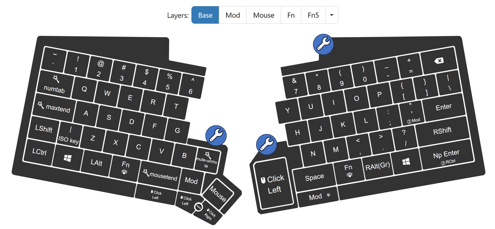

Let me have another think. Maybe a wrench :wrench: could be used.
Same thing here: I’ll have to think about it a bit more. I might get back with a suggestion.

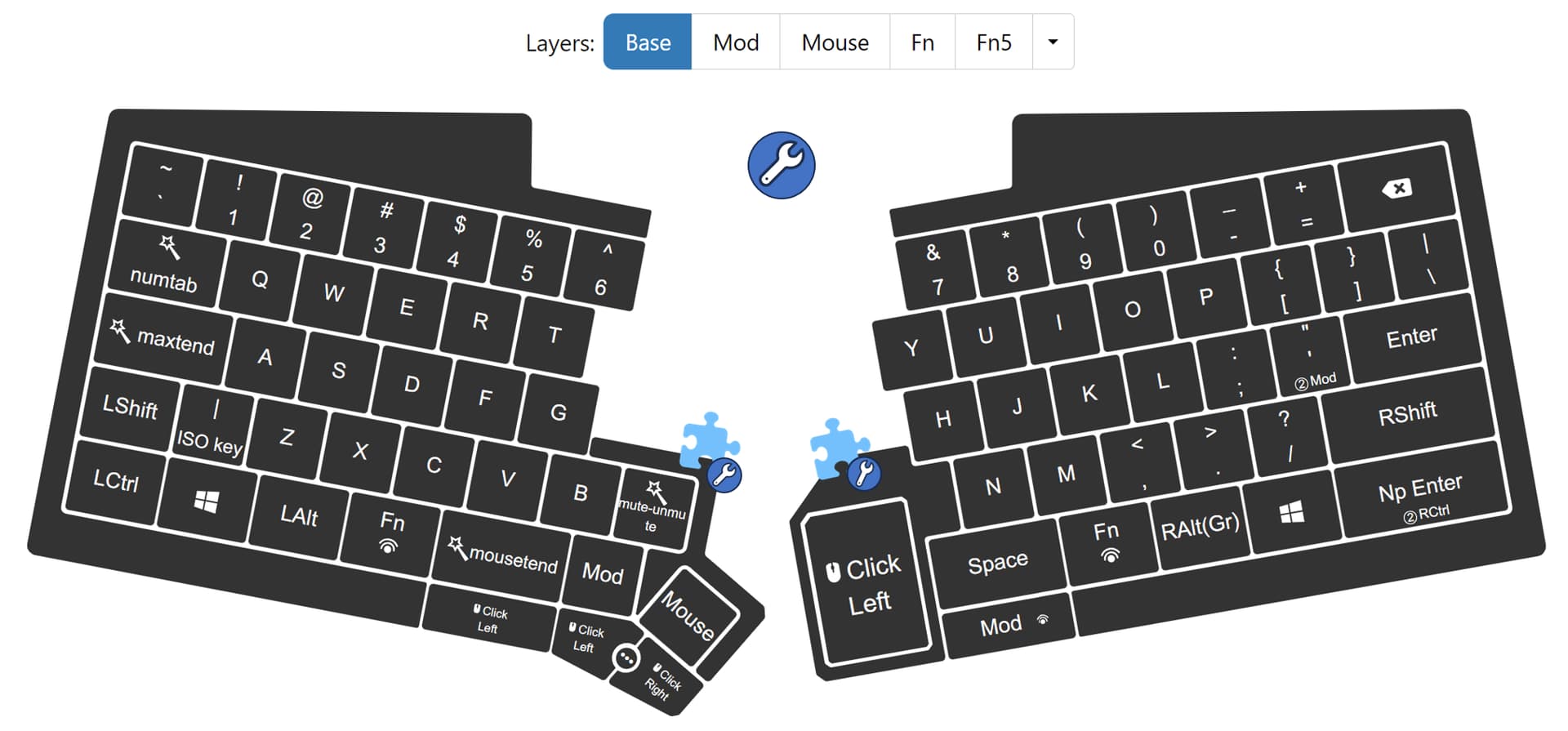

Something similar to this:
I made the icons overlap each module with the intention to make it clear what they are referring to.
Also, once you click on any of the settings icons, and you get taken to the corresponding configuration section, how would you get back to where you were? These icons do not open a pop-up window, so you don’t automatically come back to the keyboard layout once you are done configuring. But I feel it would be good to have some kind of “back” functionality that takes you back to where you triggered the wrench button.
Should Agent have a stack (history) of recently visited pages, and a back button that walks back through that history?
It feels natural for me to start off on the layout, click a wrench icon, configure some settings, then go back to where I started (without having to hunt through several keymaps to find where I previously was.

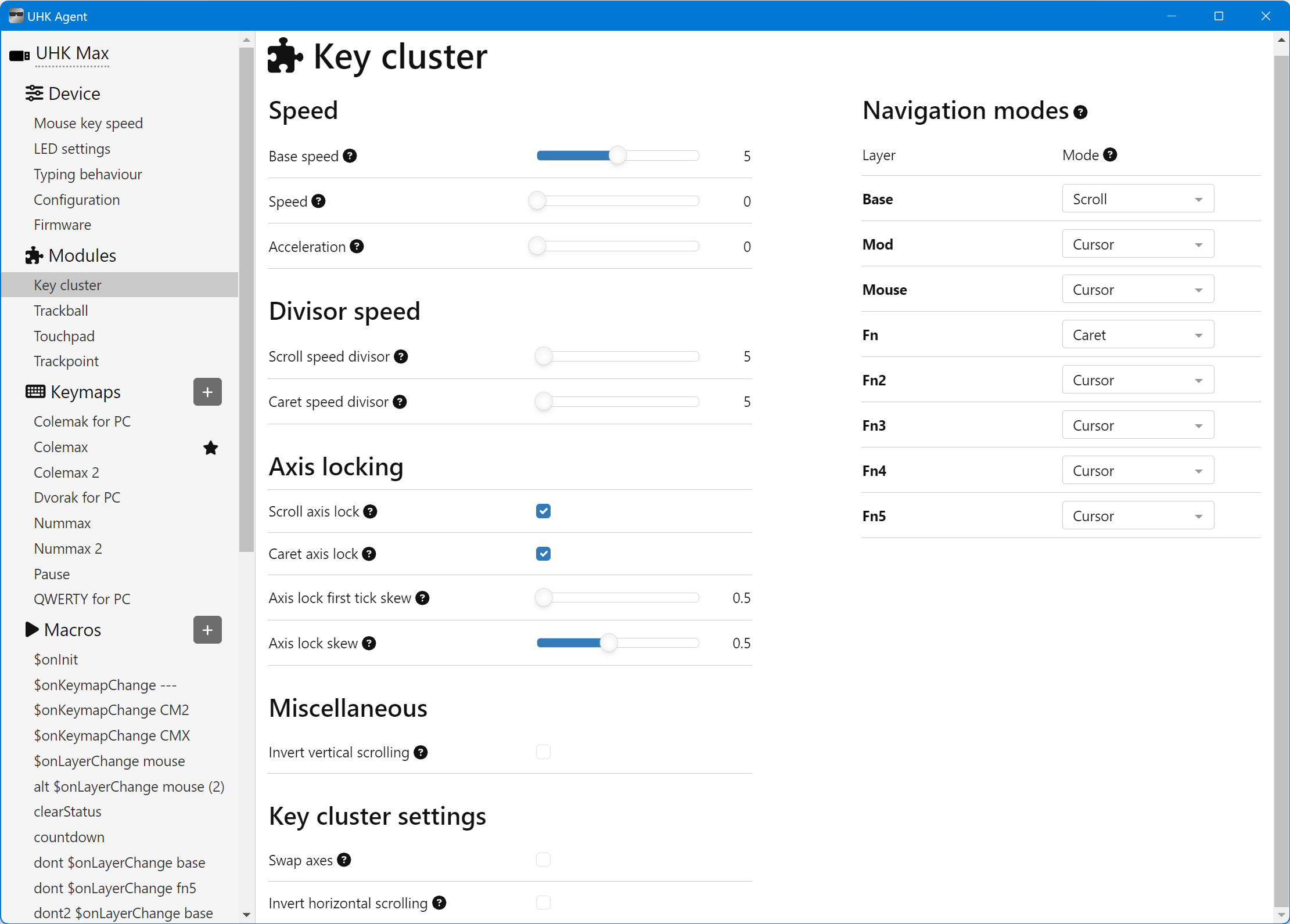

Two observations:
  1. Why are there no controls in the “Miscellaneous” and “Key cluster settings” sections?
  1. If I hover over the (?) near the bottom, e.g. at “Invert horizontal scrolling”, the pop-up hover message shows up outside the usable area of the window, and the scroll bar expands. But I can’t scroll, because when I try to scroll the hover message disappears and the scroll bar shrinks again. So there is no way to actually see the hover message. I think at the bottom of the visible area hover messages should appear above the mouse cursor, not below.
And here’s a final idea with an attempt to give a better visual indication which config wrench is for a module and which is for the whole keyboard:
Thanks for your mockups! Although I wouldn’t use colors other than the current gray color, I can see the merit of your design. I came up with the following overlapping icon design:
I don’t think featuring a settings icon on the right keyboard half is a good idea. You probably know that the right half is the master, and hence, it makes sense for you to feature a settings icon on it, but most people don’t know it, and featuring the keyboard settings icon on the right half would be confusing for them.

There are checkboxes in the Miscellaneous and “Key cluster settings” sections, but their contrast is so dim you probably couldn’t see them. We can make their contrast easier to see if this proves to be a common problem.
Thanks for the heads-up on the tooltips! We’ll fix them.
Just released Agent 4.0.2. The puzzle icons look so much better this way.

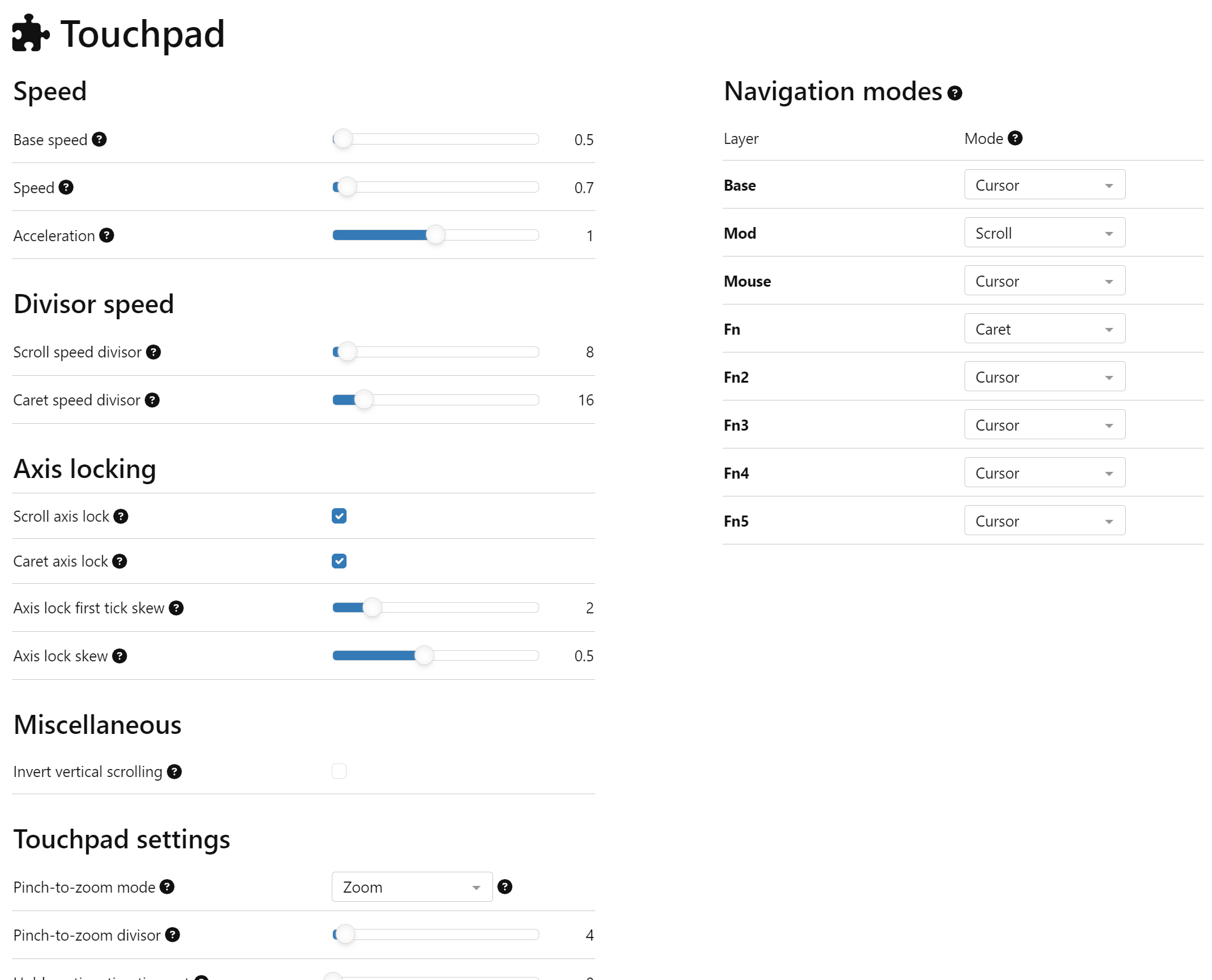

I agree with the general gist of @kareltucek about the structure of the left menu. But now I want to talk not about the structure of the menu but about the contents of some pages.
The module pages for Key cluster and Touchpad are weird. Obviously, the Agent page for each module contains the settings for that module. Now, for example, take a look at the Touchpad page:
The whole page are settings for the Touchpad. So why is there a section “Touchpad settings” at the bottom?
The same is true for the Key cluster.
I know that these sections are extras that the other modules do not have, and everything above are settings that every module has. But that’s a technical reason, not necessarily a good UI design choice.
One simple option would be to rename those bottom extra sections to something like “Additional settings”.
Or they should just get incorporated into the “Miscellaneous” section. That change would also make sense because at the moment “Invert vertical scrolling” is in the “Miscellaneous” section, but “Invert horizontal scrolling” is in the “Key cluster settings” section. That makes no sense.
Thus, rename “Miscellaneous” to “Scrolling direction” and combine all “Key cluster settings” into it (when looking at the Key cluster module).
For the Touchpad module, the “Scrolling direction” section would only contain “Invert vertical scrolling”, and the remaining settings (pinch-to-zoom and hold continuation) would be called “Additional behaviour”, “Extended behaviour”, or something similar.
(As to Invert horizontal scrolling, it would make sense to make it available for all modules, as it relates to the so called natural scrolling that our users have pointed out should be inverted in both axes, not just vertical one.)
Yes, I agree 100%. More consistent too.
