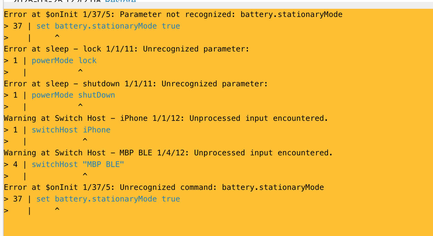

Any views on how to handle the below in Agent? When using a UHK80 configuration on a UHK60?
The switch host warnings are a bug → Fix warnings on switchHost macros with uhk60. by kareltucek · Pull Request #1212 · UltimateHackingKeyboard/firmware · GitHub
The rest of the functionality is only available on the battery_management branch, so my guess is that you have flashed master build.
(Also, we are renaming the stationary mode to set battery.chargeLimit optimizeHealth.)

Ah you are completely right, that is what I did. battery_management on UHK80, master on UHK60!
