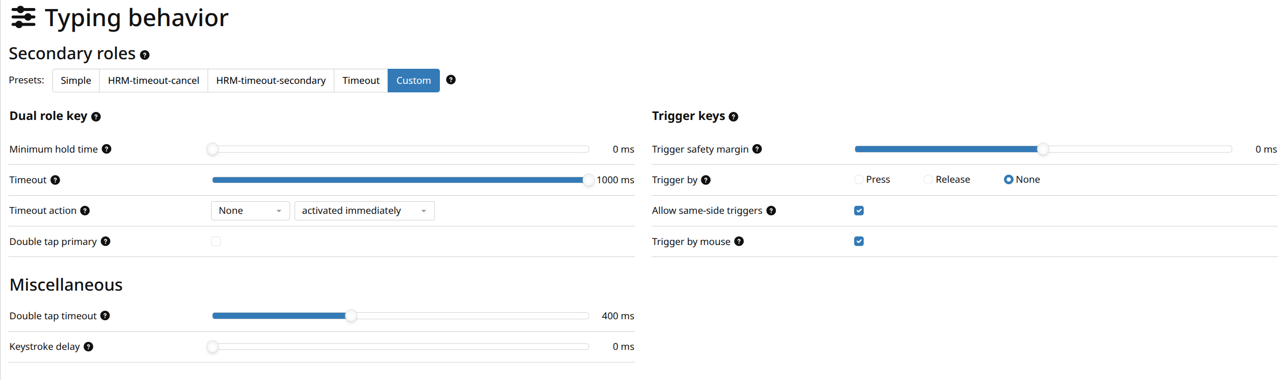

ifSecondary final holdKey b
holdKey a
With following typing behavior. Basically any settings should work, just check the Trigger by mouse one:
Usage:
  • press the key
  • move mouse before releasing the key

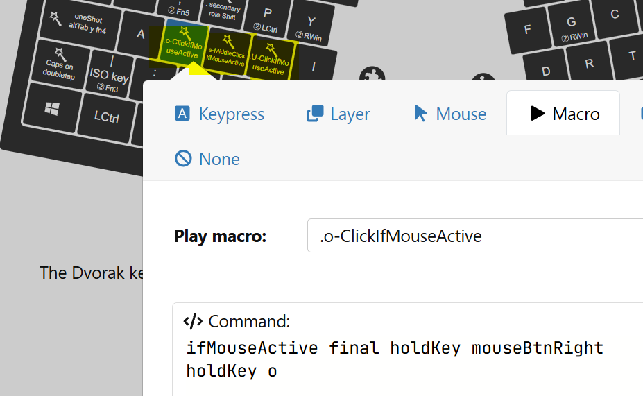

Wow, I’m really amazed with the results. I’m going to give you my first impressions.
  • It feels so natural, it responds fast and reliable.
  • I was allowed to drag and drop, and to double click with my keys.
  • And above of all, it is comfortable to use, that I was looking for on first place.
I think that I have to get use to let pass some time when I type the macro key after have sent a click with the same key to get the normal behaviour. But I perceived that the amount of time is right to switch between both behaviours and of course, I guess that is a right tradeoff.
I share with you my configuration (I use Dvorak layout).
And again, thanks a lot @kareltucek .
Cheers.
