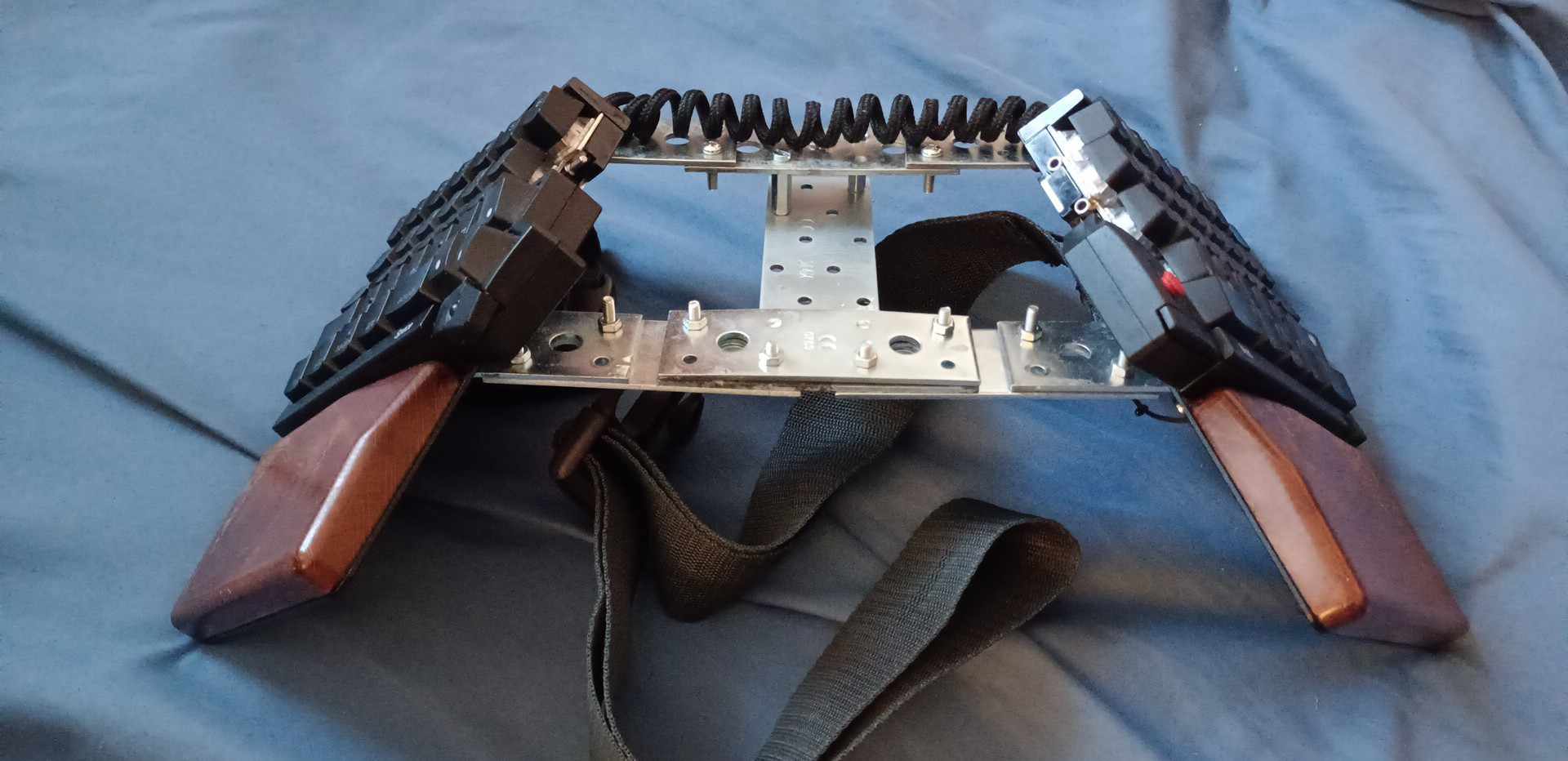

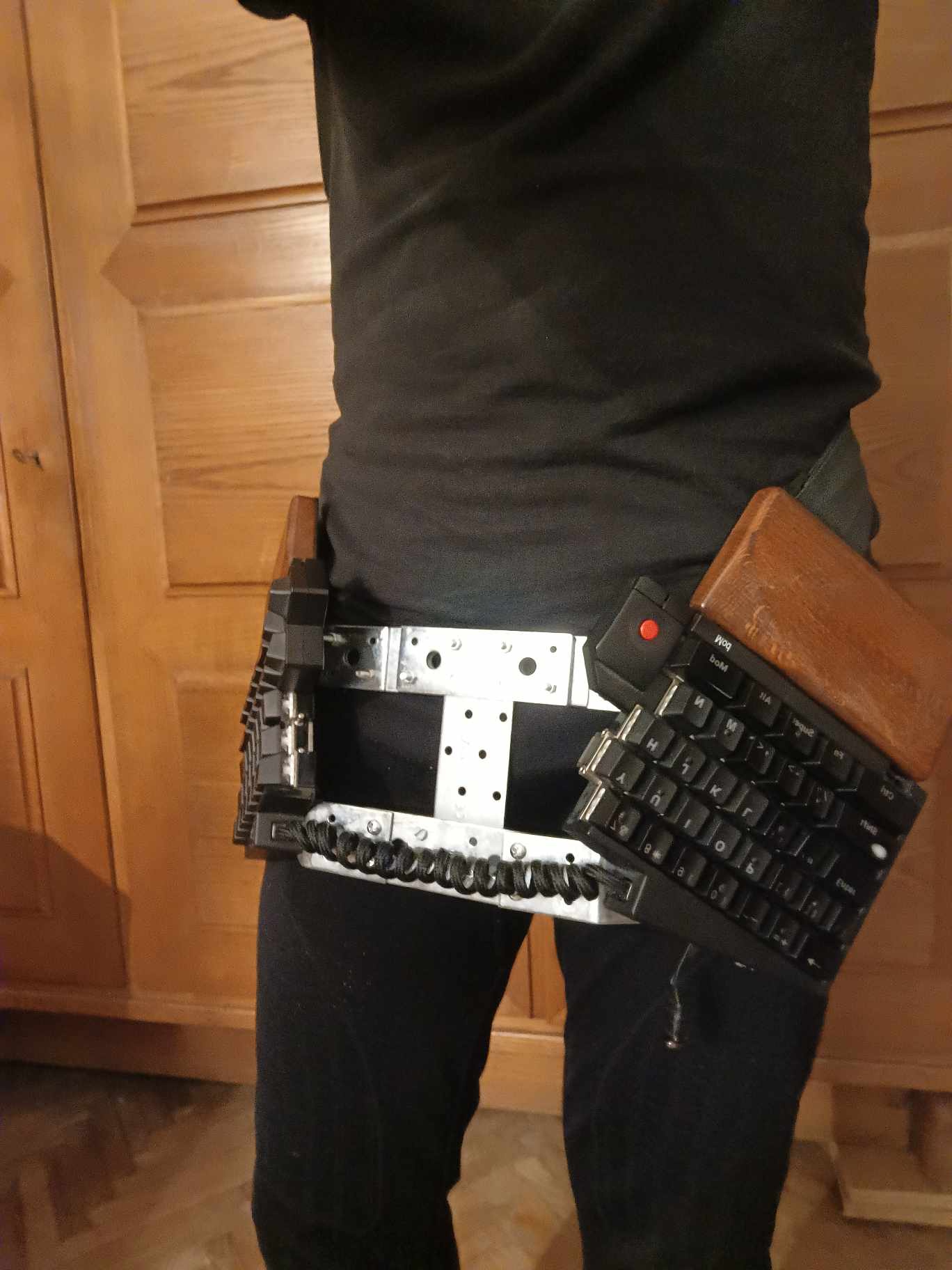

I am using this setup:
It is rock solid. Works fine when standing. When lying down, the belt has to be loosened, as it is designed for elbows to be slightly behind the body (for proper posture), so the floor is in the way of that at default height. Also works great as a tenting setup when the keyboard is sitting on the table.
Screwed together from off-shelf parts, no metal cutting/drilling needed.
As for connection, I am using a 5cm usb extension cord and a magnetic adapter, so it is easy to quickly connect/disconnect.
Another idea is to use two sheet of leather, roughly triangular. Screw the UHK to it using washers and M4 screws, and make holes for the belt to go through.
Again would probably require padding for stability.
P.S. discourse prevents me from attaching more than one photo. This is annoying!
What an epic mod! Your contraption is very unique and seems rock solid.
Sorry about the limitation of Discourse regarding attachments. Such limitations are usually sensible, and there are fewer and fewer such limitations as users level up. I think you can add additional photos in further comments.
Alternatively, you could post your mod on https://www.reddit.com/r/MechanicalKeyboards/, where it’d gain larger exposure and help spread the word.
Thanks for sharing!
Could you post a photo or even better video, how you use that setup?

Seeing your belt as you’re wearing it, it seems like there’s a new Sheriff in town! The UHK team approves this robust, cool looking design! :slight_smile:
And you made a special version for him. He is the first one with a left-hand trackpoint module! :wink:
The joy of selfie-reversal :wink: (mirroring…)
