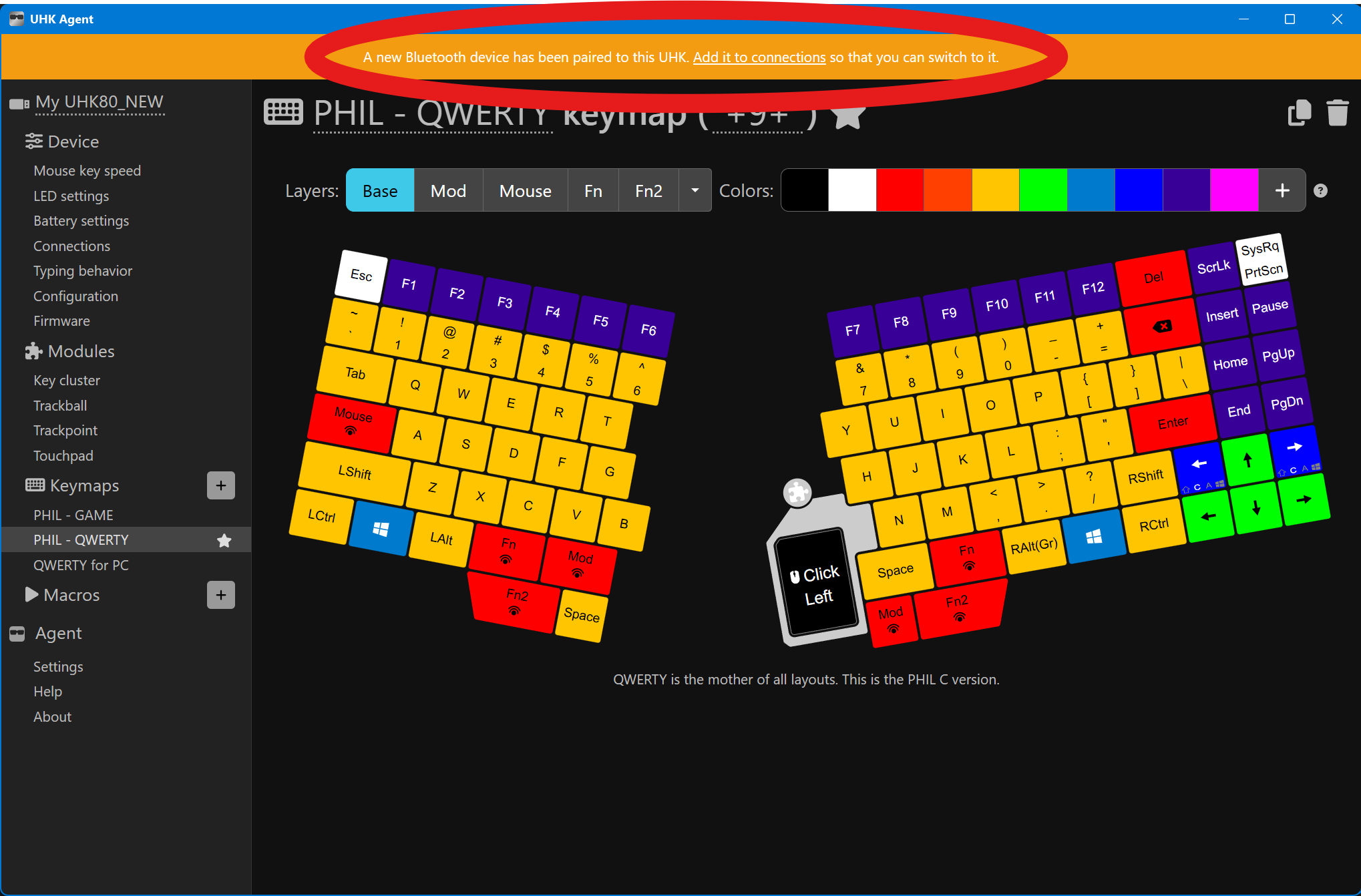

If you pair a device while Agent is open, do you see a yellow banner at the top that says: “A new Bluetooth device has been paired to this UHK. Add it to connections so that you can switch to it.”?
Actuall I have not been in the agent while connected to Bluetooth, last time I tried it said can’t find UHK or something like that. Let me try to open it again tonight while on BLE
Agent currently only recognizes the UHK when plugged in via USB. So, try pairing BLE devices while it’s also connected with a USB cable. Then you should be able to add them by using the “Add to connections” banner. That should save them into the “Connections” list, where you can rename/reorder them. Once the devices are saved to keyboard, then you should be able to switch between host connections, etc. outside of Agent.

I just checked, and it seems to be working fine for me. Using release FW v15.3.1, and master branch Agent v8.0.1 eceab78.
I unpaired from my phone, deleted all device pairings in Agent, and deleted my phone from the connections list. Then I closed Agent and unplugged the UHK80 from USB (LEDs turned off as expected).
Initiated pairing from my phone (UHK woke up as expected) and pairing was successful. Then I ended the connection to the UHK from my phone and reopened Agent. Yellow “Add to connections” banner appeared and successfully added my phone to the connections list, even with the phone disconnected :smiling_face_with_sunglasses:.
What do I do if I don’t get the yellow banner to add a new connection? I just received a new UHK80 (replacement for a recalled device), paired a Windows laptop and added it to the connections in Agent. Then later I loaded a different older UHK60 config and the connection was no longer shown in the Connections. I tried clearing Connections, removing the UHK80 from the Windows BT settings, and re-paired it, but I don’t get the yellow banner anymore. So I can’t add it to the Connections in Agent anymore.
