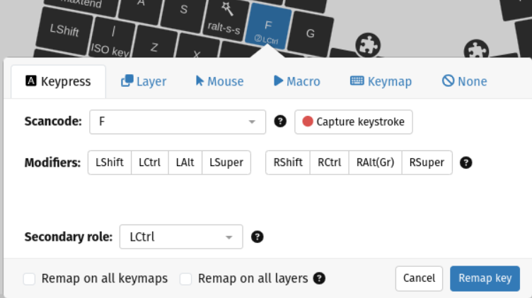

I just tried this, and the best I could come up with is this: For my test setup, I used the f key to work as Ctrl (secondary function), and d as the special key that will be sent with rightAlt (instead of Ctrl) when it’s pressed as f+d.
- I configured
fwith a secondary function to activate leftControl
- I created a macro called ‘ralt-s-s’ (but you can use any name of course) with this code:

The code is entered here as ‘Macro commands’:
- I mapped
dto run this macro:
This is the result:
- When I press
don it’s own, I get d. (You can also hold it for autorepeat.) - When I press
f+d, I get a short tap on leftControl, and then rightAlt+d. - When I press
ftogether with any other key, I get leftControl+the other key.
Autorepeat on f is lost, because holding it down is now the same as holding down leftControl.
If you want to use leftAlt instead of rightAlt, you have to change the ‘RA-’ in the macro to ‘LA-’. For my experiment it was easier to use rightAlt, because on my international keymap combining keys with rightAlt just types different international characters, and it’s easy for me to observe the effect.
