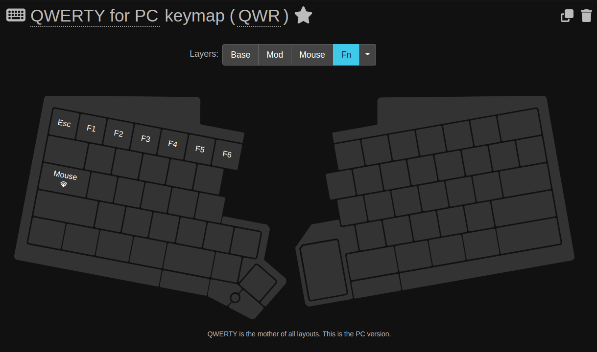

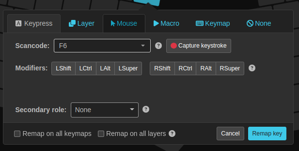

I’m trying to achieve what on a standard keyboard would be Shift+F6. I’m mapped the 6 key on my Fn layer to F6. However, the combination of Shift+F6 simply gives me the ^ symbol, as if Fn where not being pressed.
If I read this correctly, you have mapped Fn-6 to F6. Are you then pressing Fn-Shift-6 on the keyboard? You should be getting a Shift+F6 keypress sent to the computer.
Thank you for the reply, yes – here is the mapping (below), and here is me pressing FN+Shft+6, ^^^^^^;

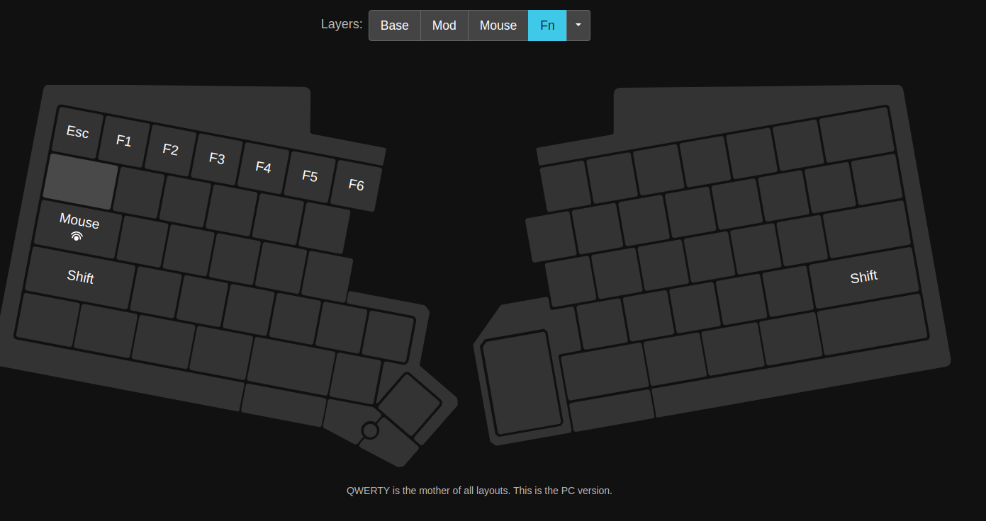

Please, post screenshot of your entire fn layer :-).
Right. I mean that that wide key in left bottom corner of your screenshot has to read shift.
I feel silly now – thanks for your patience;
Change is made as below, saved to keyboard, but still doesn’t seem to have changed the operation.
Dear goodness, I think I see the issue now. Somehow FN is not mapped on my base layer – I am an idiot.
That fixed it, so sorry to have wasted everyone’s time. Thank you for the help.
