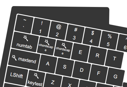

I then assigned it to the q and w keys:

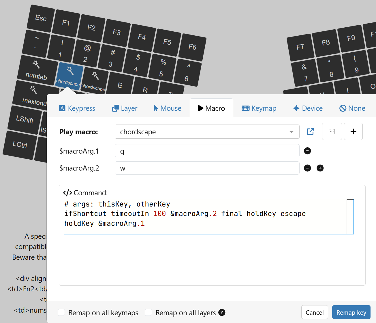

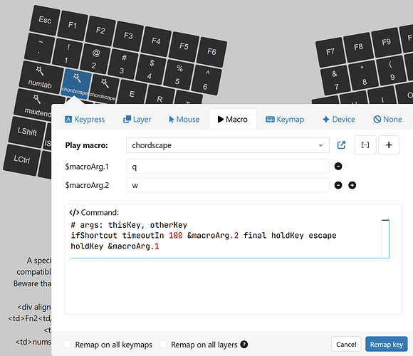

Since firmware 16.1.0, macro arguments can be used to simplify the chordscape macro:
chordscape:
# args: thisKey, otherKey
ifShortcut timeoutIn 100 &macroArg.2 final holdKey escape
holdKey &macroArg.1

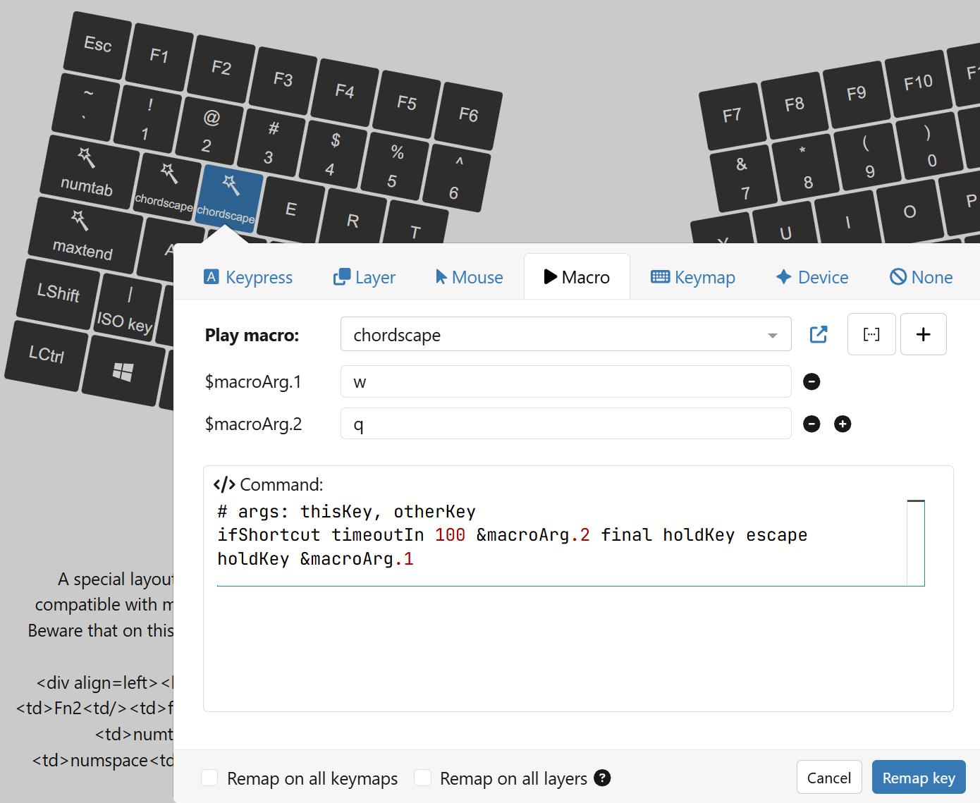

Now, the key mappings for q and w can be configured:
On q:
On w:
this seem really interesting, but why is required setup for the w as well? to ensure bidirectional behavior of the chord?
Yes. The macro gets triggered by the first keypress. If you want the chord to work either as q+w as well as w+q then you have to configure it on both keys.
