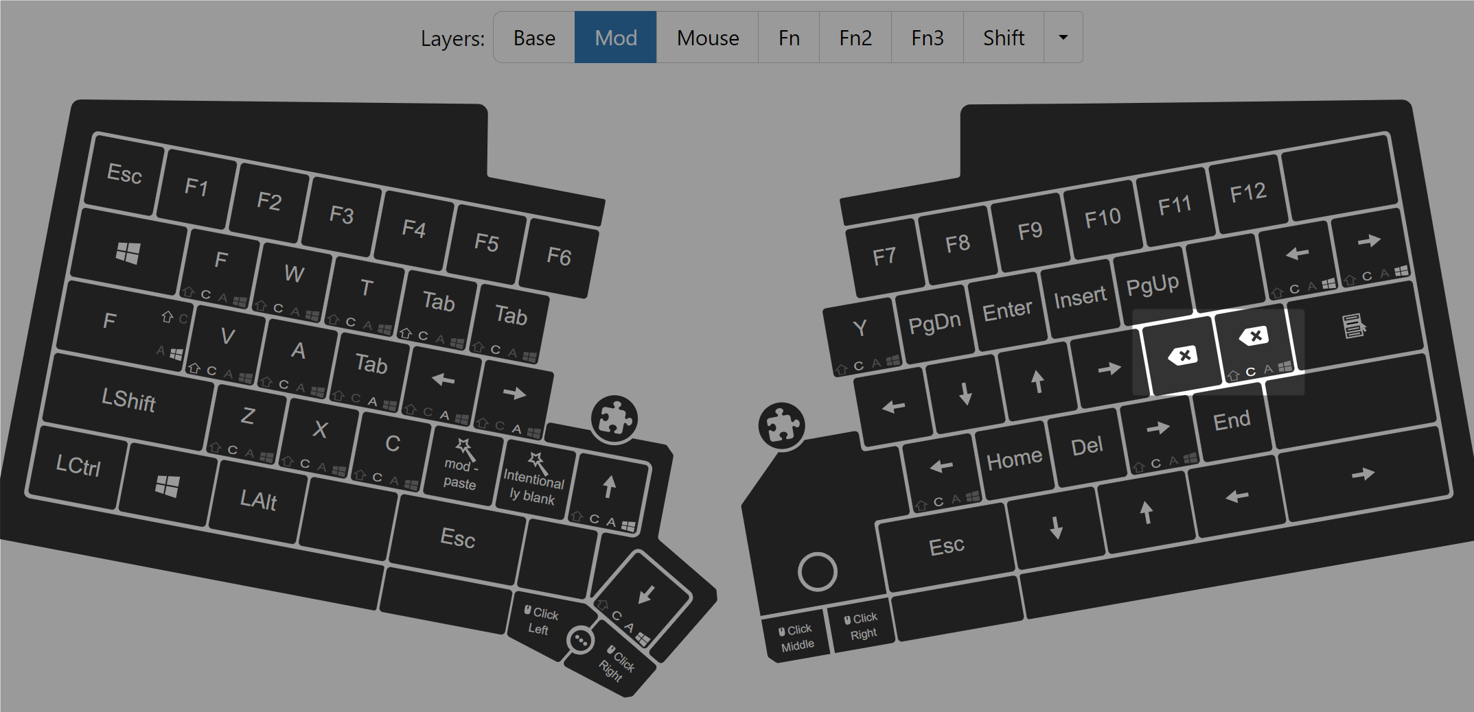

I have it on my mod layer, which is triggered with the left or right space key (while hold, tap is space). I have an extra key to delete whole words as well. That works very nice for me. I also have Enter in that layer (i-key) and do not use the main Enter key while touch typing. Finally ESC is the mod key itself. So holding the right space key and tapping the left will trigger ESC and vice versa as well. :smiley:

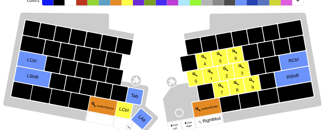

So I basically never reach anything outside 26 + 2 keys (backspace and esc).
Ctrl + key = hold G (or V) + key
Shift + key = hold M (or U) + key
Ctrl + Shift = hold both G + M (V + U)
and etc…
,.=_$ = hold T + key or right side of home row
and etc…
arrow left / right / … = hold Mod key + iaeoh (hjkl on usual keyboard layout)

If we are talking about my Carpalx - keyboard layout optimizer layout it took pretty decent amount of time. I initially changed alphabet layout without any other changes. But since I’m a software engineer and use a lot of Ctrl / Shift / Alt / Combinations and non-convenient . , : ; () [] {} etc I started experimenting with these modifications too.
I tried many very different approaches and designs, but it didn’t work quite well. For example using some key to change layer to type . , : ; () [] {} etc very slow for just one such key (which is most of the time) and you have to type 3 keys - <enter mode key> <key> <leave mode key> which is very annoying. Also it reqired a lot of cognitive load to use nested layers or layer which might go to another layer (not main). Design took several years - right starting from UHK arriving. But you can just take it as is, saving these years :))
First, my design is not about speed. In reality I don’t care about speed at all (staring at 100 lines of code whole day :)) ). It’s about comfort. If you have finalized design - learning it is now the least problem.
