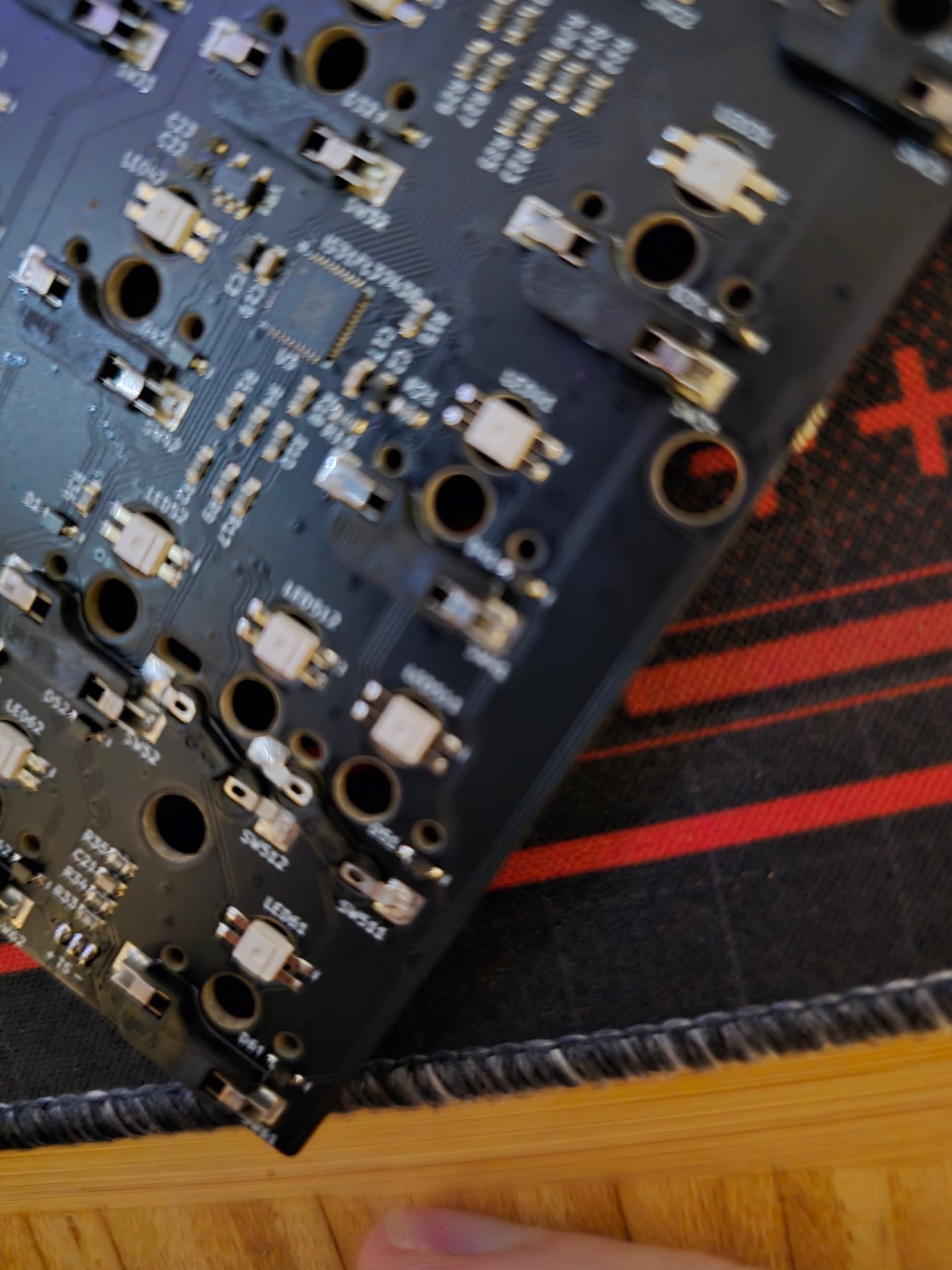

A lead of the socket may have separated from the circuit board. Can you possibly check? You’d have to disassemble the relevant keyboard half.
I haven’t gotten the chance to check but this is probably the reason. As i press down ctrl, it oscillates between on and off, sometimes continuing to do so when held down. How would i fix this?
Can you show some pics?
If the pad has lifted off the PCB, then it’s likely gonna need a little surgery…
The soldering socket of the Ctrl key appears correct, but it’d be better to take a photo of the socket terminals from an angle not perpendicular to the board and closer.

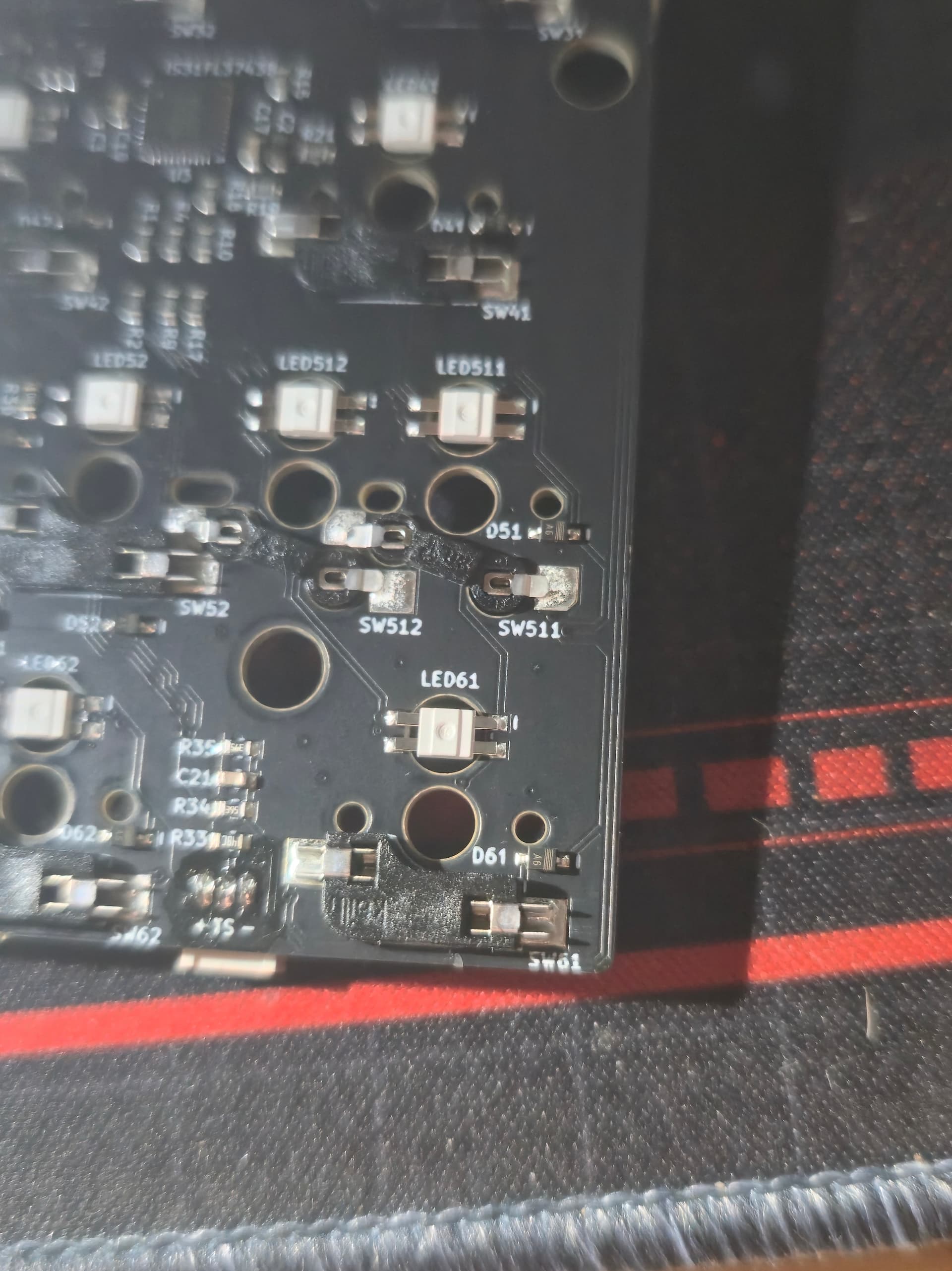

That bottom, right square pad looks like it might be slightly deformed…
If you VERY GENTLY lift up on that socket, does it look like there’s any separation? Don’t use any force, of course. You don’t want to damage it while checking… ![]()
