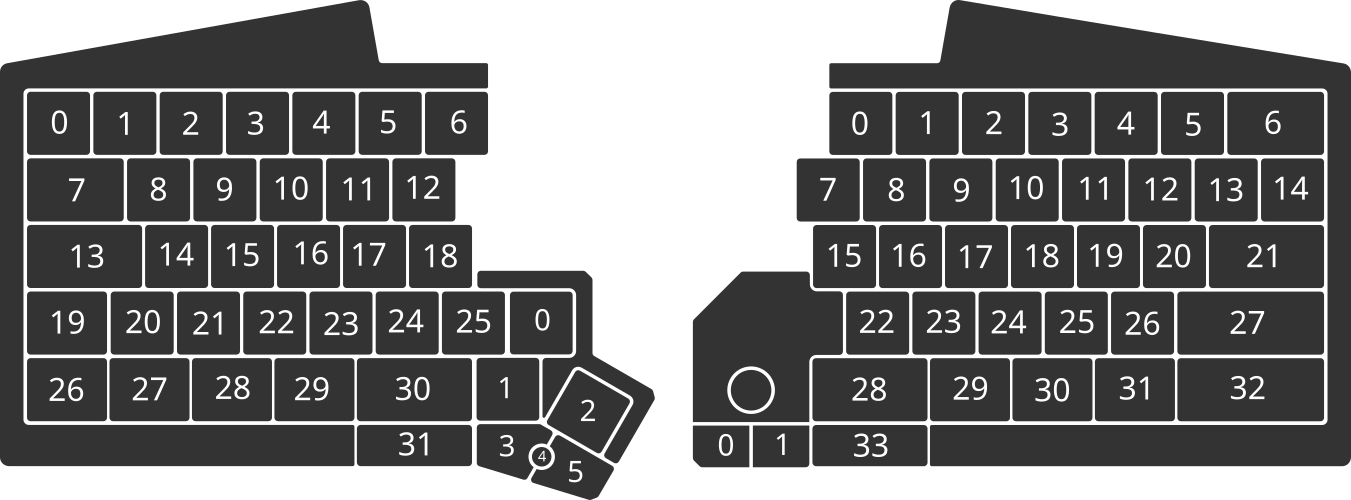

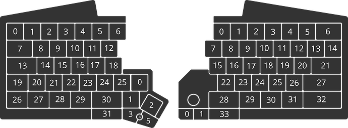

is there a hw positions matrix available? that would make many macros pretty independent of keymap making things much easier and transparent … i think.
Yes, I am sure there is somewhere on the forum (or maybe github), just use search.
Or you can simply use the resolveNextKeyId macro.
i think i found it here. Ill try with resolveNextKeyId.

so for example on querty my key would be in position 88 and in colemak is in position 89.
if i try ifShortcut v final tapKey G-$keyid.89 instead of ifShortcut v final tapKey G-v all i get is unrecognized key abbreviation. I tried as in documentation keyid (89) but getting same error.

Still unclear how i can use this in macros, keyid as well since macro syntax seem to accept abbreviations only. Maybe physical positions as abbreviations?

made it work with keyid as well. like ifShortcut (84) final tapKey LG-z. I made a layer specially to input directly whatever keyid i want to use, somehow resembles me to zmk configurator…sort off.

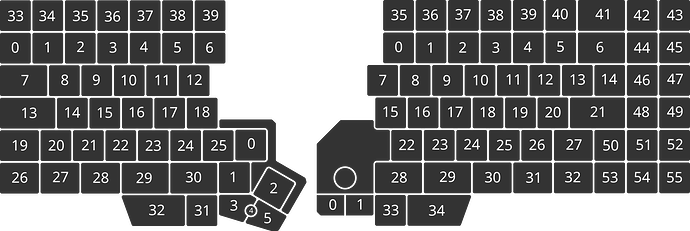

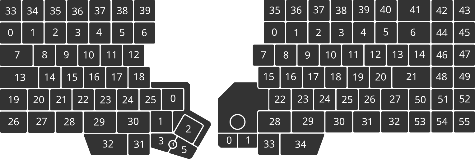

I have forgotten we have these:
Add following offsets to the per-slot keyids to get actual keyid:
  RightKeyboardHalf = 0
  LeftKeyboardHalf  = 64
  LeftModule        = 128
  RightModule       = 192
