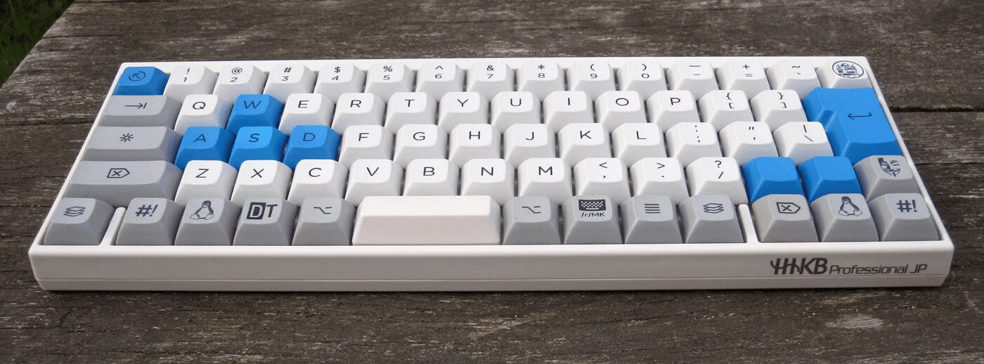

your best chance might be a flat, non-sculpted profile like DSA or XDA.
This way you can easily swap positions.
DSA:
XDA:
Ignore the spacebar, it’s the original one.

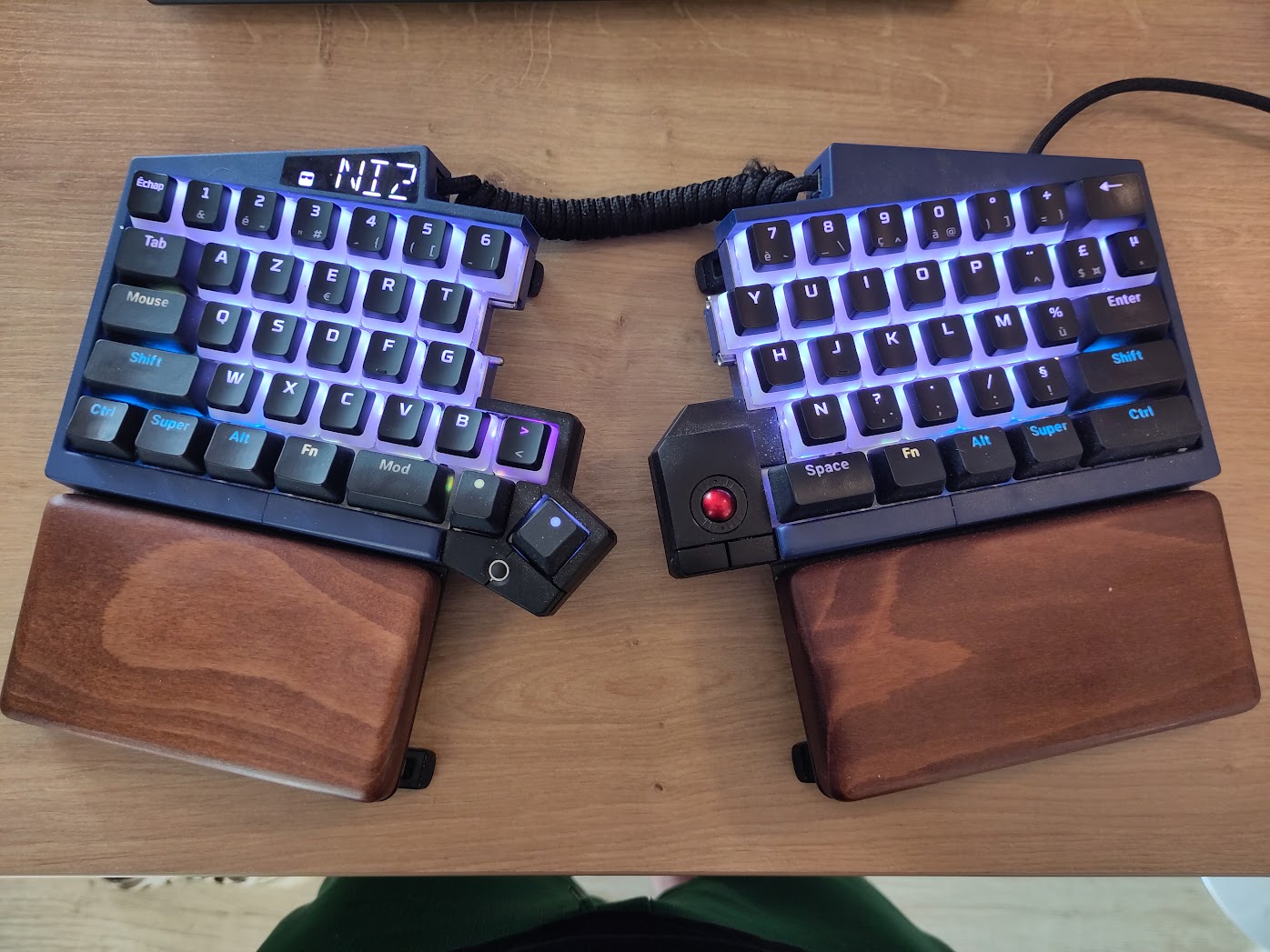

Hi! thanks for this complete answer!
What I had in mind was to keep from the original UHK (v2, by the way) all the “special” caps (I mean space, enter, module, etc.) and only swap the character keys.
I have already tried to swap the keys shipped with the UHK
but what I miss are the accentuation keys from the french AZERTY layout.
I tried to map chars with accents with some marco (ie: fn+e = é) but in the french layout these keys are available without any key combination and I definitely don’t manage to get used to the macros.
In the link you gave, very few provide the keys I want (I found none in PMK, for instance)

This is a complete different situation and makes it easier, because you don’t have to mess around with modifier keycaps.
Looking at your picture, it’s easy to recognize the mismatch of profile per row. The Z and W keycaps “don’t fit” in the sense it is supposed to be used.
But it’s absolutely fine, if you can live with that!
yeah you saw it! It sometimes a bit annoying, but I can live with it

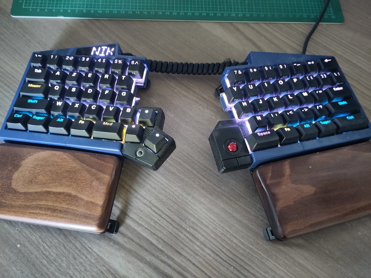

aaaaand, here it is!
I only had to create a macro for the “<>” key
and there is only one letter in the the third row on the right panel, which is not optimal I guess, I also tend to prefer original caps, but I really feel better with it now.
