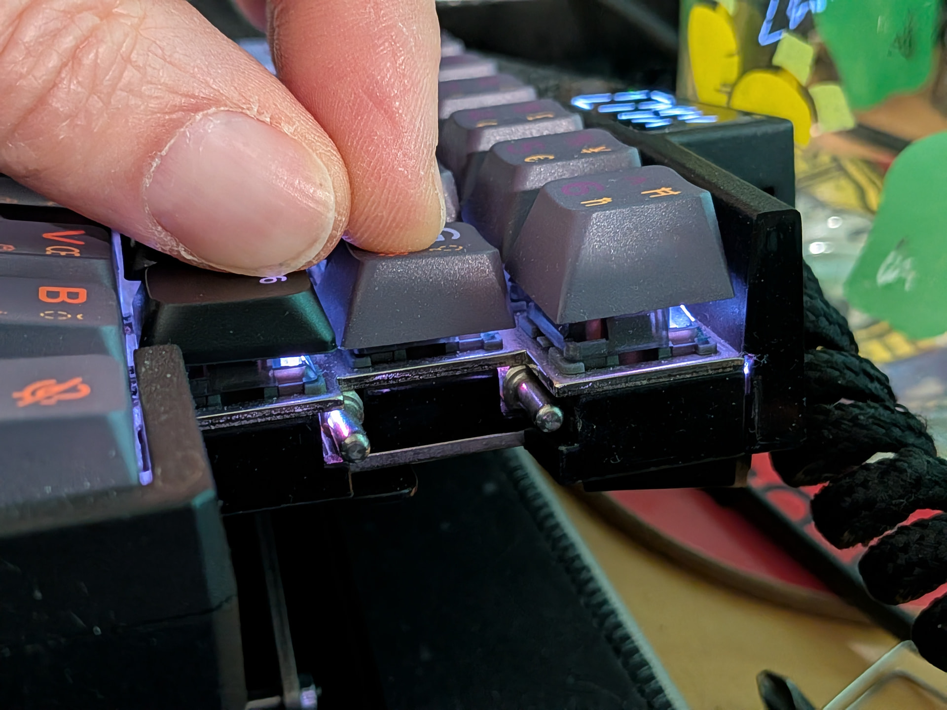

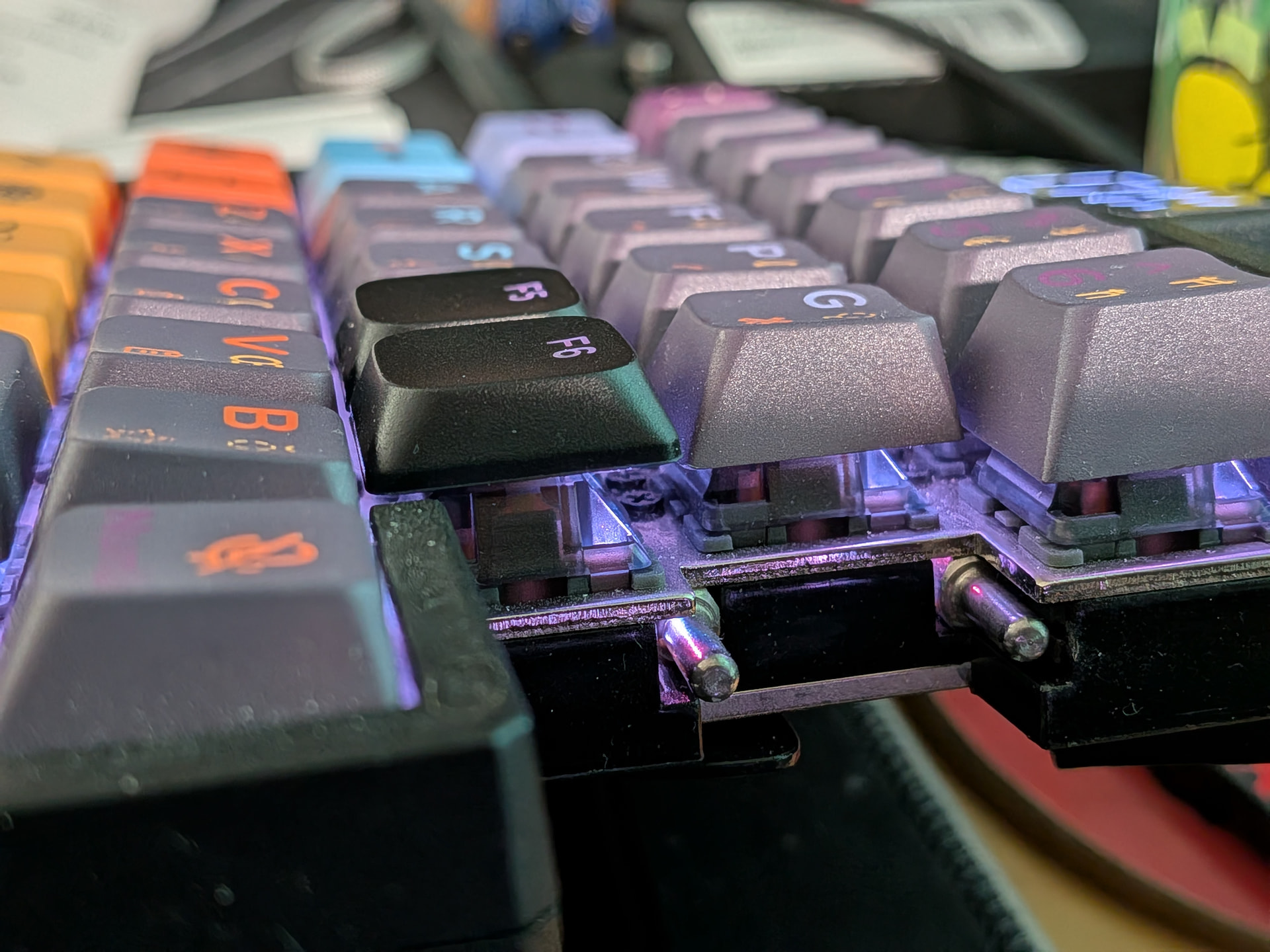

I don’t have LPF caps, but here is a photo of XVX Skyline caps (the black ones) vs. Cherry profile sitting on a UHK60v2. You can see that the flatter XVX caps do not cover the light source as much as the Cherry ones. It’s even more pronounced when you press them.
