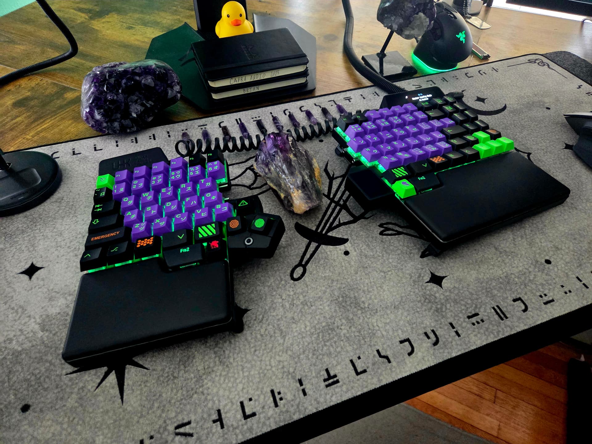

Swapping between devices is already so much faster and more stable than the USB switcher I was using before.
Where did you get the key caps?
this is the Drop + FU11.META1 GMK Mecha-01 base key set with novelties
What is that USB cable?
