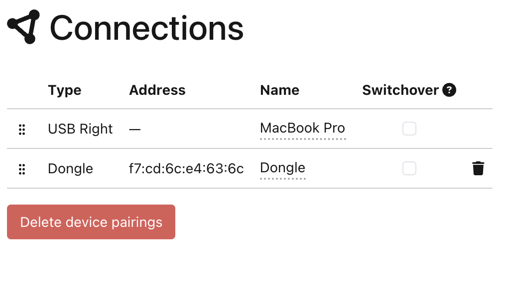

Hi, I was happily using the UHK 80 during a gaming session when suddenly it dropped the connection to the Dongle and wouldn’t reconnect anymore. The dongle is violet now which seems to indicate it is in pairing mode, but not paired.
I tried updating firmware to 16.0.0, resetting the right half, removing and readding the dongle connection - and yes, I get the yellow banner after removing the connection, and it seems to pair fine - only that the Dongle doesn’t seem to want to know anything about it and insists on staying violet instead of becoming blue. :sweat_smile:
I also added a switchHost next macro, but the UHK seems to only know about the USB (“My PC”) connection, despite two connections (USB to right half and Dongle) listed in the agent.
Adding and executing the reboot macro also didn’t help.
Now I can only use my UHK if the right half is connected via USB which is a shame. :disappointed_face:

Bringing this back….
I have my UHK80 wired, and BLE connected, and is all good there.
I can pair the Dongle and see it in violet. I’ve no advertising or the like in my $onInit.
No matter what I do I cannot get it to connect to the dongle. (That being said most of what I am trying to do is just change the connections to 2:Dongle.
Any thoughts on what else to try?
Only the two connections and cannot get the dongle to be connected.
