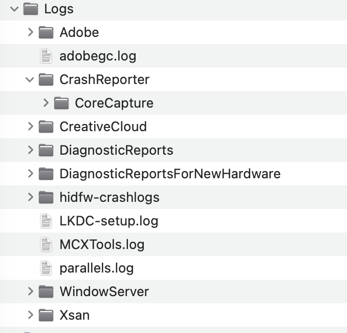

How can I get the agent log?

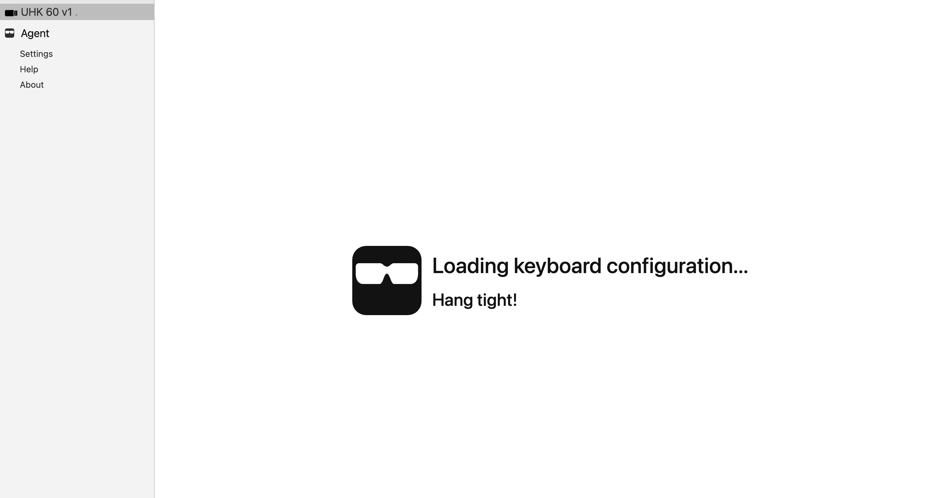

Now, on my screen, it looks like this. It’s an infinite loading.
Run it from terminal.
Or, I guess more conveniently (kudos to Robi):
You can find it in the following path
• on Linux: ~/.config/uhk-agent/uhk-agent.log
• on macOS: ~/Library/Logs/uhk-agent/uhk-agent.log
• on Windows: %USERPROFILE%\AppData\Roaming\uhk-agent/uhk-agent.log

    at async ds.getHardwareModules (/Applications/UHK Agent.app/Contents/Resources/app.asar/electron-main.js:5:1354415)
    at async ds.uhkDevicePoller (/Applications/UHK Agent.app/Contents/Resources/app.asar/electron-main.js:5:1370596)
12:23:07.790 › [UhkHidDevice] Available devices unchanged
12:23:07.793 › [UhkHidDevice] Used device: {"vendorId":"0x37A8","productId":"0x3","path":"DevSrvsID:4294973878","serialNumber":"9693408510","manufacturer":"Ultimate Gadget Laboratories","product":"UHK 60 v2","release":2,"interface":4,"usagePage":65280,"usage":1}
12:23:07.799 › [UhkHidDevice] productId: 3 protocol versions: {"firmwareVersion":"12.3.3","deviceProtocolVersion":"4.14.1","moduleProtocolVersion":"4.3.0","userConfigVersion":"8.3.0","hardwareConfigVersion":"1.0.0","smartMacrosVersion":"3.1.0"}
12:23:07.807 › [DeviceOperation] Read "leftHalf" version information
12:23:07.809 › [DeviceOperation] Read "leftHalf" repo information
12:23:07.813 › [DeviceOperation] Read "leftHalf" firmware checksum
12:23:07.815 › [DeviceOperation] Read "leftModule" version information
12:23:07.817 › [DeviceOperation] Read "leftModule" repo information
12:23:07.821 › [DeviceOperation] Read "leftModule" firmware checksum
12:23:07.823 › [DeviceOperation] Read "rightModule" version information
12:23:07.826 › [DeviceOperation] Read "rightModule" repo information
12:23:07.831 › [DeviceOperation] Read "rightModule" firmware checksum
12:23:07.838 › [UhkHidDevice] Transfer error:  Error: Communications error with UHK. Response code: 3
    at ar.write (/Applications/UHK Agent.app/Contents/Resources/app.asar/electron-main.js:5:1257635)
    at async oo.getRightModuleProperty (/Applications/UHK Agent.app/Contents/Resources/app.asar/electron-main.js:5:1300777)
12:23:07.839 › [UhkHidDevice] Device communication closing.
12:23:07.839 › [UhkHidDevice] Device communication closed.
and for the file, I can’t find them on my mac :frowning: it has no uhk-agent folder.
Alright, please rerun with --log=usb argument and post logs again.
Also see if the agent can retrieve that uhk status buffer content from the uhk via Agent’s --print-status-buffer argument.
