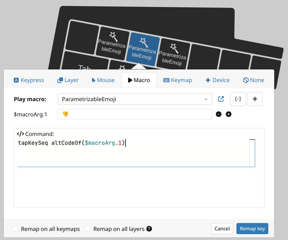

This simple example allows you to bind an emoji alt code onto a key (since firmware 16.0.0 / Agent 9.0.0).
tapKeySeq uCodeOf(&macroArg.1)
Then, when binding the macro to a key, just click the [...] icon and copy paste your emoji or any other unicode character.
That’s it.

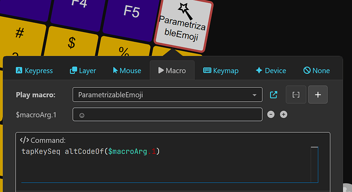

I’m not sure why, but when I try your example by pasting :smiling_face: in the $macroArg.1 field, it outputs :. If I use a normal macro with tapKeySeq pLA np1 rLA, it gives a proper :smiling_face:. I tried with several emojis, etc., but it’s the wrong output no matter what I use :man_shrugging:.
Using FW v16.0.0 and Agent v9.0.0, and as usual, I’m on Win 11. Any ideas? I don’t use alt codes very often, so I may just be doing something dumb :sweat_smile:. I just wanted to try this out.

I tried again today using the © “Copyright Sign” (alt code is Alt+0169):
•Manually typing it in works fine. Produces the correct © “Copyright Sign”.
•Using a macro with tapKeySeq pLA np0 np1 np6 np9 rLA also produces the correct © “Copyright Sign”.
•Using a macro with tapKeySeq altCodeOf(©) produces the ⌐ “Reversed Not Sign” (alt code is Alt+169).
•Using a ParametrizableEmoji macro with © pasted in the $macroArg.1 field also produces the ⌐ “Reversed Not Sign”.
And again using the € “Euro Sign” (alt code is Alt+0128):
•Manually typing it in works fine. Produces the correct € “Euro Sign”.
•Using a macro with tapKeySeq pLA np0 np1 np2 np8 rLA also produces the correct € “Euro Sign”.
•Using a macro with tapKeySeq altCodeOf(€) produces ¼ “Vulgar Fraction One Quarter” (alt code is Alt+0188).
•Using a ParametrizableEmoji macro with pasted in the $macroArg.1 field also produces ¼ “Vulgar Fraction One Quarter”.
I tried both increasing and removing my keystroke delay (usually set to 10ms) to see if that was the issue, but there was no change.

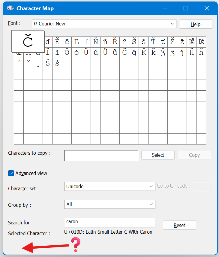

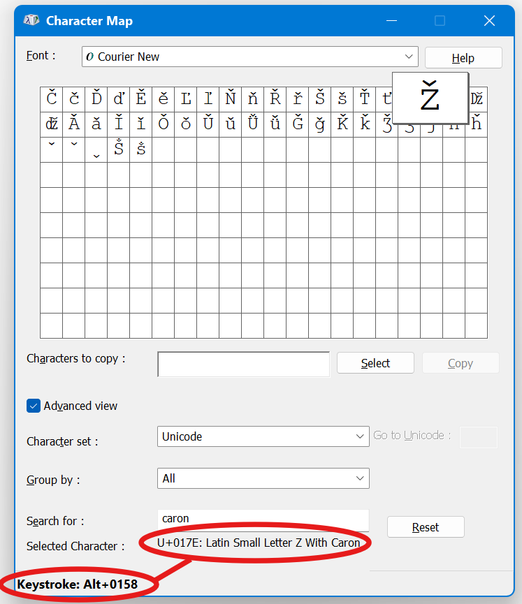

Sorry if this is a jumbled mess. This is just one of the most convoluted rabbit-holes I’ve gone down in a while :face_with_spiral_eyes:. TBH, I’m no longer sure what’s an actual Win Alt-code or some other dec/hex/unicode, and when/how to use which version. The Windows Character Map’s alt-codes vary wildly from other sources:
So anyway, I’m not sure if I’m entering codes correctly, or if alt-code is always even the proper terminology :man_shrugging:. If you can offer more specific directions for me to follow, I’m glad to help further. Since there doesn’t seem to be any consistency with how Windows handles the codes, I’m at a loss for where to go from here.

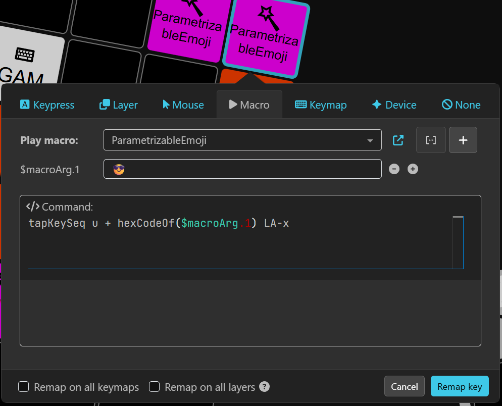

Thankfully, the following works fine in Windows Notepad, which is good enough for me ATM :smiling_face_with_sunglasses:.
