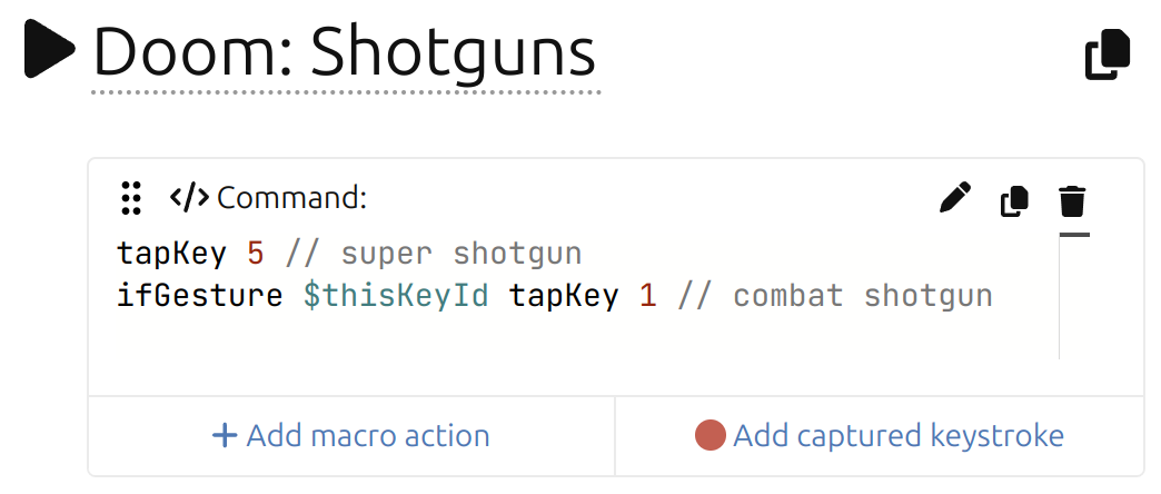

• Dual use keys •
Triggering two different actions with one key can be useful.
This is @mlac’s DOOM: Shotguns usecase.
The following will select the super shotgun upon single-tap, and* the combat shotgun when double-tapping:
ifDoubletap final tapKey 1 // combat shotgun
tapKey 5 // super shotgun
*Potential quirk with the above macro…
Double-tapping that macro outputs both a 5 and a 1 for every double-tap. That might not be the desired behavior if your usecase is to select an in-game item. It might be fine for switching shotguns in DOOM, but not so much if you’re trying to select instant-use items.
e.g., Imagine you have grenades mapped to the 5 key (single-tap), and health potions mapped to the 1 key (double-tap). If you need to replenish your health, it doesn’t help much if you dropped a grenade on your toe while reaching for a health potion…
