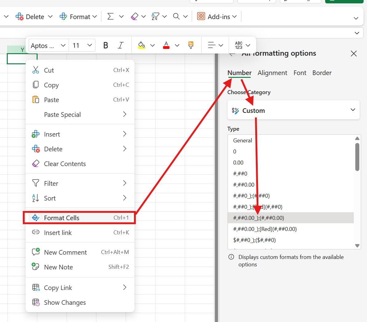

I don’t know my way around Excel, but I think they’re trying to set up a macro to navigate formatting presets. So I think the N is meant to be typed text to bring up the “Number” tab, and CUS text to bring up the “Custom” preset from the drop-down menu.
I took this screenshot in the free online Excel app:
The shortcut keys seem to be different in the online version, so Idk exactly what sequence works properly in the desktop version. Using online version, I need to use Tab or arrow keys to navigate, because typing to select “Number” section and “Custom” preset doesn’t work.
