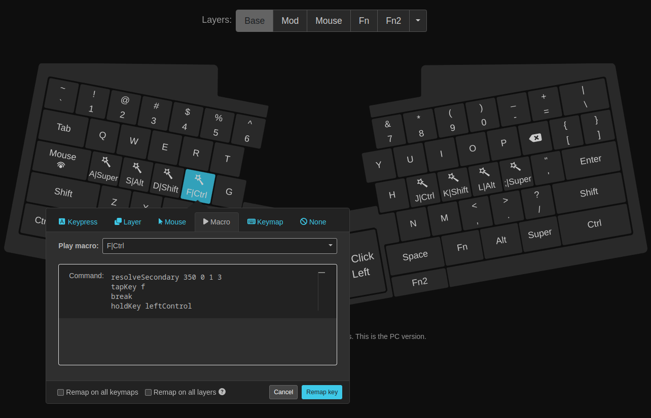

I use Home row mods extensively. So far the following configuration works well for me but I keep experimenting with timings. Sometimes, when I type too fast, I get false primaries. But, more importantly, with the current timings, I rarely get false secondaries.
Still, when typing super fast, I prefer using natural Shifts. Home-row-mods Shifts are more convenient to be used in combinations but are rather inconvenient for fast typing because of intermittent false primaries. It’s kind of hard to control the order of presses when typing unconsciously.
Oh this is nice, I was wondering if there is a way to have deeper configuration of the HRM-timings, which is exactly what your macros seem to do. Up to this point I only experimented with regular secondary roles on keys, which led to quite a few issues, because i tend to roll words a lot.

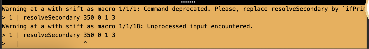

hm, weird - holding the key to create shift in my case works, but tapping does not produce the output character.
I also tried it with holdLayer fn3, which didn’t work either. Any idea, what I could be doing wrong here?
@proostas oh I think I figure it out - could it be that there is an error in your syntax? You are using resolveSecondary 350 0 1 3, however the ‘0’ shouldn’t be there, as far as I can tell

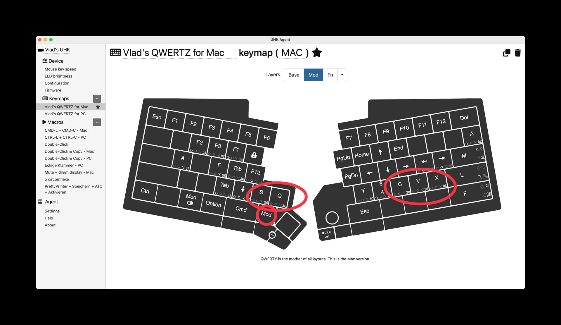

I like to use both hands for copy / paste / etc. so I press with left Mod and with right the macros for CMD - C / V / X etc.
No rules without exceptions
: I save and quit apps using one hand only - that’s why I minimized the distance between Mod and these keys
After some days of testing I decided to ditch home-row-mods and like you just assign the most important shortcuts (Ctrl- XCVZAWST) to my mod-layer. Reason is that false triggers of shortcuts can be really disrupting, needing time to fix or even dangerous. When typing fast (65 wpm to 85 wpm average with 120 wpm bursts) the chance for false triggers is simple too big. So home-row mods for shortcuts are for me not worth the hassle.
P.S.: I am now testing the right case-button as Ctrl, which makes left hand Ctrl-shortcuts also easy and pretty quick.
