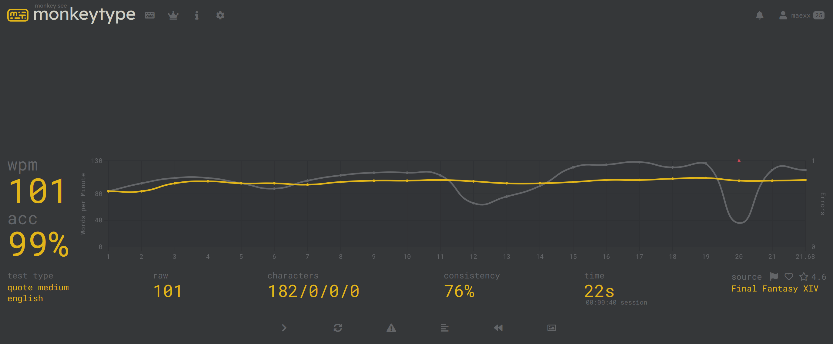

How people type that fast is beyond me. I simply cannot parse what I see into motions that fast. My record is around 50 WPM on monkeytype, English 10k with punctuation. I use those settings to get all letters, and some special characters in order to practice my layout.
Monkeytype, English 10k, punctuation, quote medium. Your HRM implementation works well. I get the occasional non-fire, but it’s on a very similar level as I had with ZMK. It’s where the best timing and algorithms can’t differentiate anymore what my fingers are trying to convey. :slight_smile:

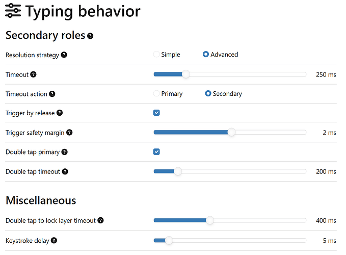

These are my timing settings:
In addition, I set set secondaryRole.advanced.acceptTriggersFromSameHalf false in my initialisation macros.

No, I don’t use trigger on mouse. I just use a 250ms timeout, which is good enough if I need to shift-click or ctrl-click. I might increase that to 350ms.
