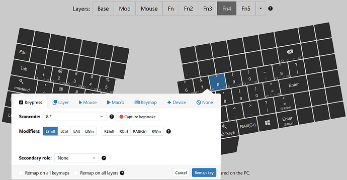

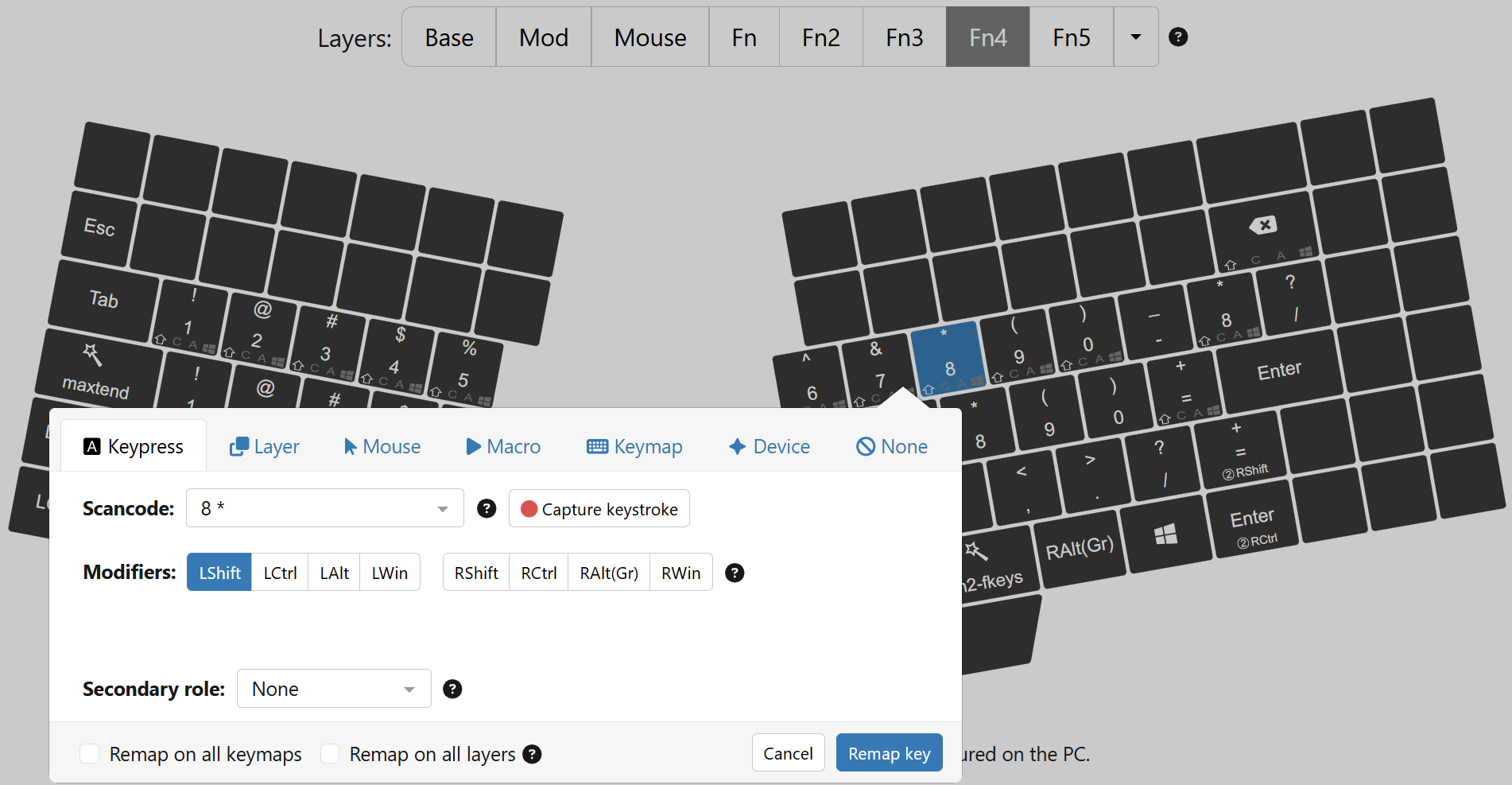

My i key maps to ‘8 *’ with LShift on the fn4 layer – it’s supposed to produce an asterisk (‘*’). When I hit it during quick typing as rightSpace+i it sometimes comes out as ‘*’ and sometimes as ‘8’.
It seems that the UHK processing logic looses the LShift in certain circumstances.

My base layer maps the p key to scancode ‘p’, and my host keymap is Colemak, so this scancode will map to ;:, resulting in ; character unshifted and : character shifted.
My fn4 layer (which gets activated by the numspace macro (see above) as secondary action) maps the p key to ‘)’ (= scancode ‘0 )’ with LShift), which is also mapped to character ) by the host keymap.

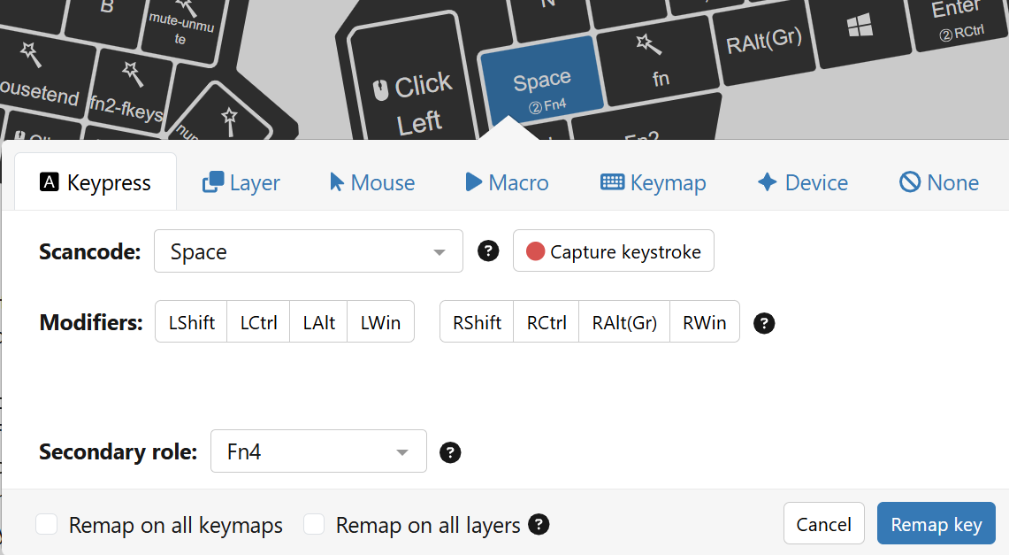

If I configure the rightSpace key as a normal keypress with secondary layer, and set secondaryRole.advanced.acceptTriggersFromSameHalf true (globally), then the activations work fine, and shift is always consistently activated.
So with direct configuration of Keypress including secondary, the behaviour works as expected.

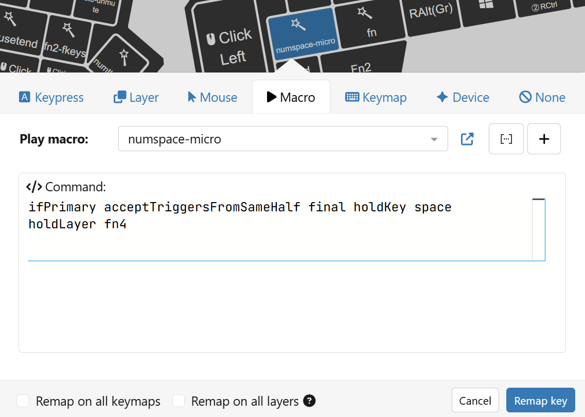

But: I don’t want the global acceptTriggersFromSameHalf, so I need to put the secondary activation in a macro. Here’s the minimum macro:
ifPrimary acceptTriggersFromSameHalf final holdKey space
holdLayer fn4
Now I can change the global default to set secondaryRole.advanced.acceptTriggersFromSameHalf false, and I configure the key to activate the minimum macro:
With that configuration, the sporadious shift problem happens.
