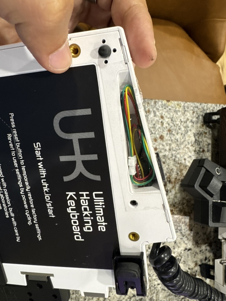

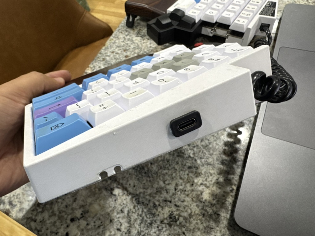

I finally converted my UHK v1 to USB C. The mini usb port had annoyed me for a long time so I opened it and did the mod myself. I used one of those tiny usb c adapters and wired it through a 4 pin connector so I can still take it apart. The wires aren’t short and the inside is kind of scrappy, I even used clear tape in the cable bay.
I had to dremel the case for the port and also shave a bit of the bottom case to get more room to work. It was kind of a mess while I was doing it but it came together and the port alignment ended up way better than I expected.

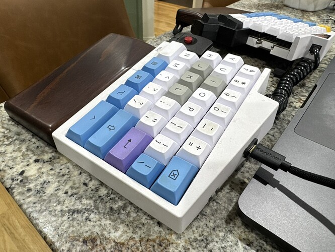

It’s way more convenient for me now and I think it looks nice. If anyone wants to try it I can share the parts and what I learned.

Using a JST connector is, in my opinion, the key to keeping the whole thing serviceable, since the USB-C socket and the PCB live on different parts of the enclosure.

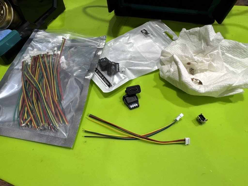

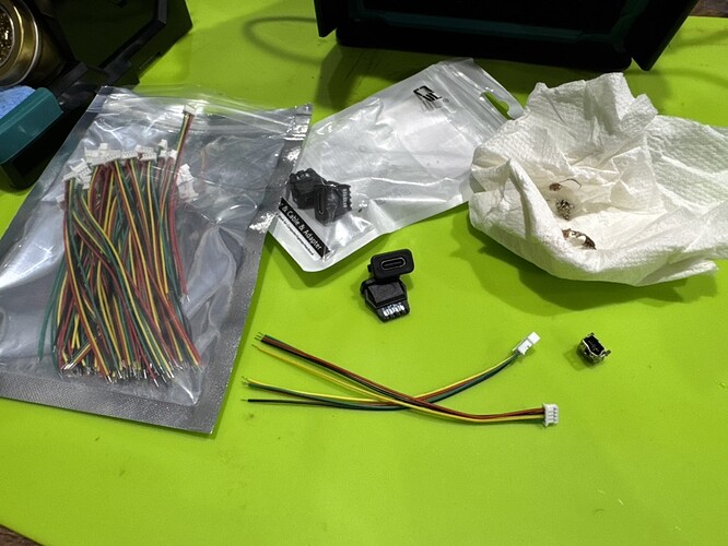

The parts I used were:
