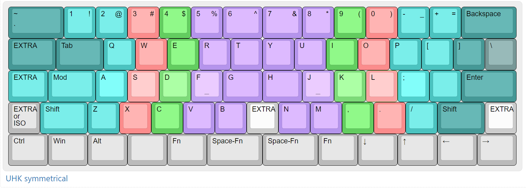

Idea for future UHK: key arrangement in symmetrical stagger (instead of columnar stagger)
The UHK has some strong points and a few unique ones. One of the advantages (and disadvantages at the same time) is the standard row stagger. That means the keyboard will be largely compatible to other keyboards, but has the drawbacks of a row staggered keyboard. Columnar stagger would resolve those drawbacks, but will be very different from a standard keyboard. I think a unique value proposition of a future UHK could be offering a layout close to a standard keyboard, but still getting rid of the row stagger problems. So in a perfect world UHK would offer three versions: row stagger, symmetrical stagger and columnar stagger.
A symmetrical stagger would allow to have almost a standard key arrangement, but just get rid of the row stagger. This would be highly beneficial as it makes switching between the UHK and standard keyboards more seamless. An ideal symmetrical stagger would consider ANSI and ISO layouts and would also allow to keep the number 6 on the left side or move it to the right side.

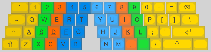

There is a website dedicated to symmetrical stagger. Their idea is like that.
I think that is the way to go in general, but I would fine-tune the number of keys and the stagger on the number row (likely to have no stagger on the number row, because that is closer to a standard keyboard and also natural to reach). Note that in the example the stagger is only 1/4 key width for the bottom row, which I think is better, then the default 1/2 key offset.
When there is interest to discuss that idea in more detail I will make a suggestion for a complete key arrangement and possibly also make a video demonstrating why that is potentially a great solution.
P.S.: I am aware of the X-Bows keyboard, which is a nice concept, but IMO gets it wrong in several places – mainly the too large distance between the fanned keys and some strange key sizes as well.

No, you can design the symmetrical stagger key arrangement (plus the modifier keys) in such a way that is indeed closer to standard board than ortholinear. That btw. is a plus point to keep the half-width lower row stagger.
Where do you get that impression? All I say is that there can not be a perfect keyboard with all keys in perfect places. We need too many letters and some layer switches and some function keys (on layers or direct ones). As soon we optimize one position for a finger another position next to it will become worse for the same finger.
Finally. It is always a matter of some sort of “compatibility” for any keyboard you design. If that was not the case you would create your own keymap, optimize the position of the layer keys (shift and symbol layer), without constraints (considering other fingers than the pinky or thumb), would include the option of foot switches (not handy for laptop use on the go) and so on or look at different concepts like the Svalboard or other ones you would come up with.
My thinking is that there is a need and likely also a market for a very compatible key arrangement (to standard keyboards), while fixing the stagger problems and allowing to use the keyboard as close to a normal keyboard as wanted, but at the same time to offer the freedom to depart from that by using layers on the thumb and in non-standard places (for example on the CapsLock, '-key). Such a board would also allow to move keycaps to the wanted places (fully or at least to a certain degree). The UHK is by far in the best position to be that keyboard, because of some unique advantages it has. The only real non-compatibility needed is the movement of the 5 top-row keys (qwert) – fixing the only real problem a standard keyboard has!

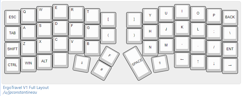

I’ve looked at Corne, Lily58, Iris etc. The Corne seems to be quite popular, and I could give it a go, but I feel it takes too many keys away. It matches a lot, but not all of my requirements (esp. #5 is missing).
You can also check out this split keyboard comparison tool that allows you to print out original size keyboards (or keyboard halves) on A4 paper. With that you can check how your hands fit various layouts.
What I found matches my requirements and my hands is the ErgoTravel. Now I am tempted to buy a kit and build one.
It’s close enough to the current keys available on the UHK (minus the number row), and has a bit more thumb keys. I think it would allow relearning quickly.

Would be great to type on and would be close to a standard layout, would allow two Fn keys (one on each side, relatively easy to reach with the thumb) would offer arrows, all standard modifiers, and have some extra keys for whatever one wants (Media control, PrintScreen, Hyper, Macros…).
I think that this would be a unique offer to the market and allow significant easier adaption than typical columnar stagger keys with thumb keys in places, where you are forced to keep your thumb in the position the keyboard dictates, instead of giving the room the two half space keys offer. So different hand sizes will not have a problem and also different positioning of the two halves will work for all people. Where you place the keyboard and how you angle it, has influence on the position where the thumb naturally will fall.
Another advantage is the compact layout in the depth, which allows to either attach a palm rest or if preferred to keep the keyboard close to the front of the table without a palm rest, or when using it in one piece on the lap.
P.S.: The keys: 6, 7, G and H could also be 1u keys, but then leave a small gap, which I would not mind, when the halves are connected. But then one could swap keys – especially the numbers – much easier. Some will prefer to keep the numbers on the standard position, while others will want to split after the 5 and not the 6 possibly. The middle extra key could also be omitted, depending on the connection of the two halves. The extra key left of left Shift would change position for ISO-boards, or one could just make an ISO-version and people can assign Shift to the 1u key or their ISO-character.
Changes to a standard stagger are 0.25u shift of the number row to a bit better position and to be symmetrical. Also Space is shifted inwards 0.25u and the lower character row has only 0.25u stagger instead of 0.5u, the 0.25u stagger for top and bottom row feels better to have them equal.
I just posted some thoughts on key layouts (positions of the physical keys) about columnar and symmetrical stagger on Reddit. Might be interesting for some of you possibly?
Join me there or discuss here, when it is related to the UHK. I have thought quite a bit and had a very serious look into the different key layouts and still think a symmetrical staggered UHK could be the endgame keyboard, which so far none is IMO.
