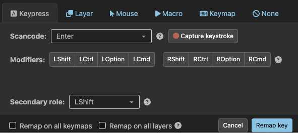

This is what I mean:
It’s a macro keymap pressing the shift key, and not the shift keypress. Sorry if my verbiage if off.
As you can see, I used leftShift instead of the iLS as you mentioned. Maybe this was the issue? I got it working so far for now, but will test again soon and report back.
Okay, went back and made this change. Now, using the macro and new keymap works as expected. To conclude, the following scripts worked to resolve my issue.
