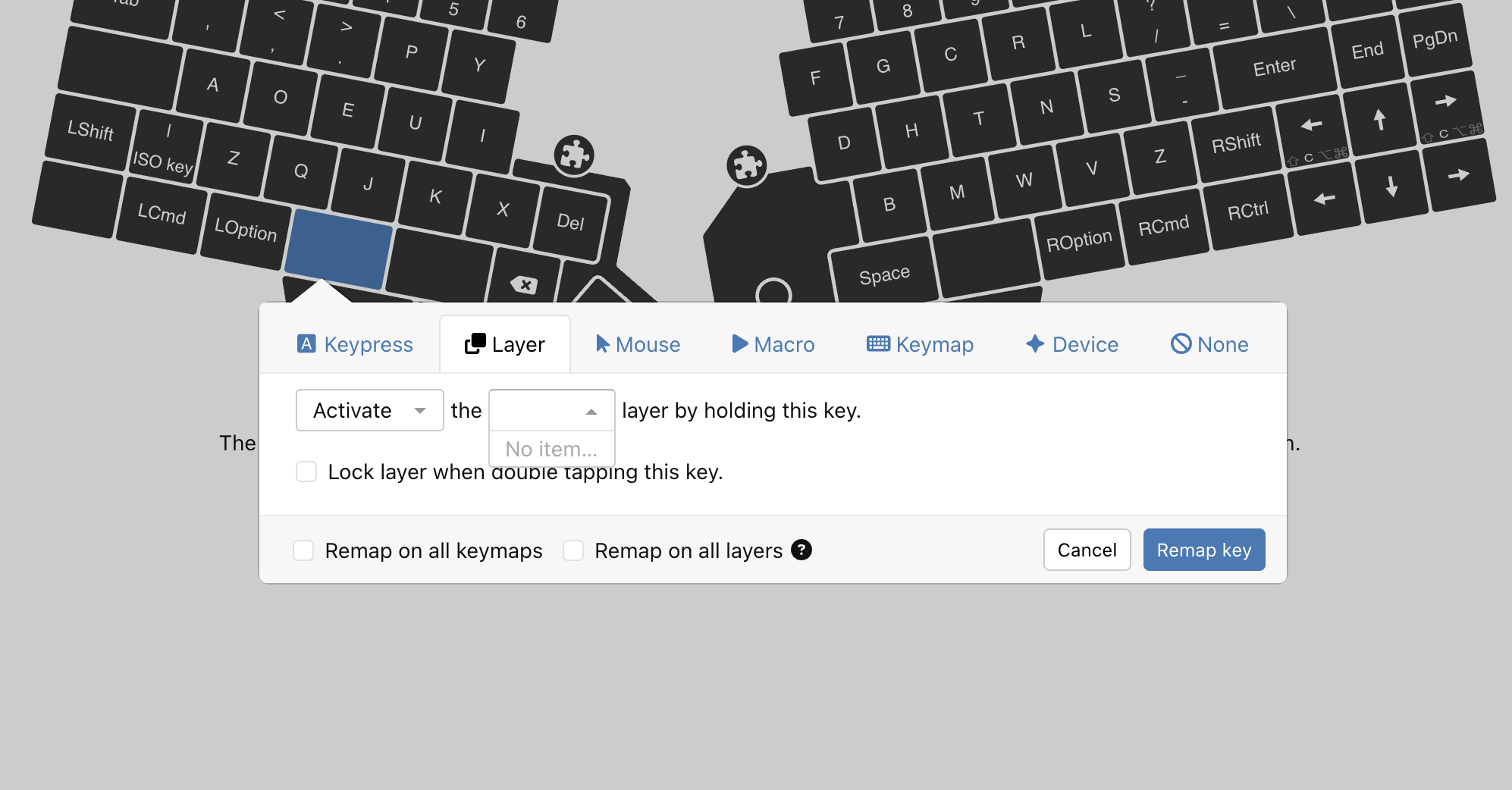

I have my base layer in CDH. With no mod layer, fn layer, fn4 layer etc, then the Activate dropdown in the Layer tab is empty
What do you do for the Mod, FN, FN2, layers etc?
