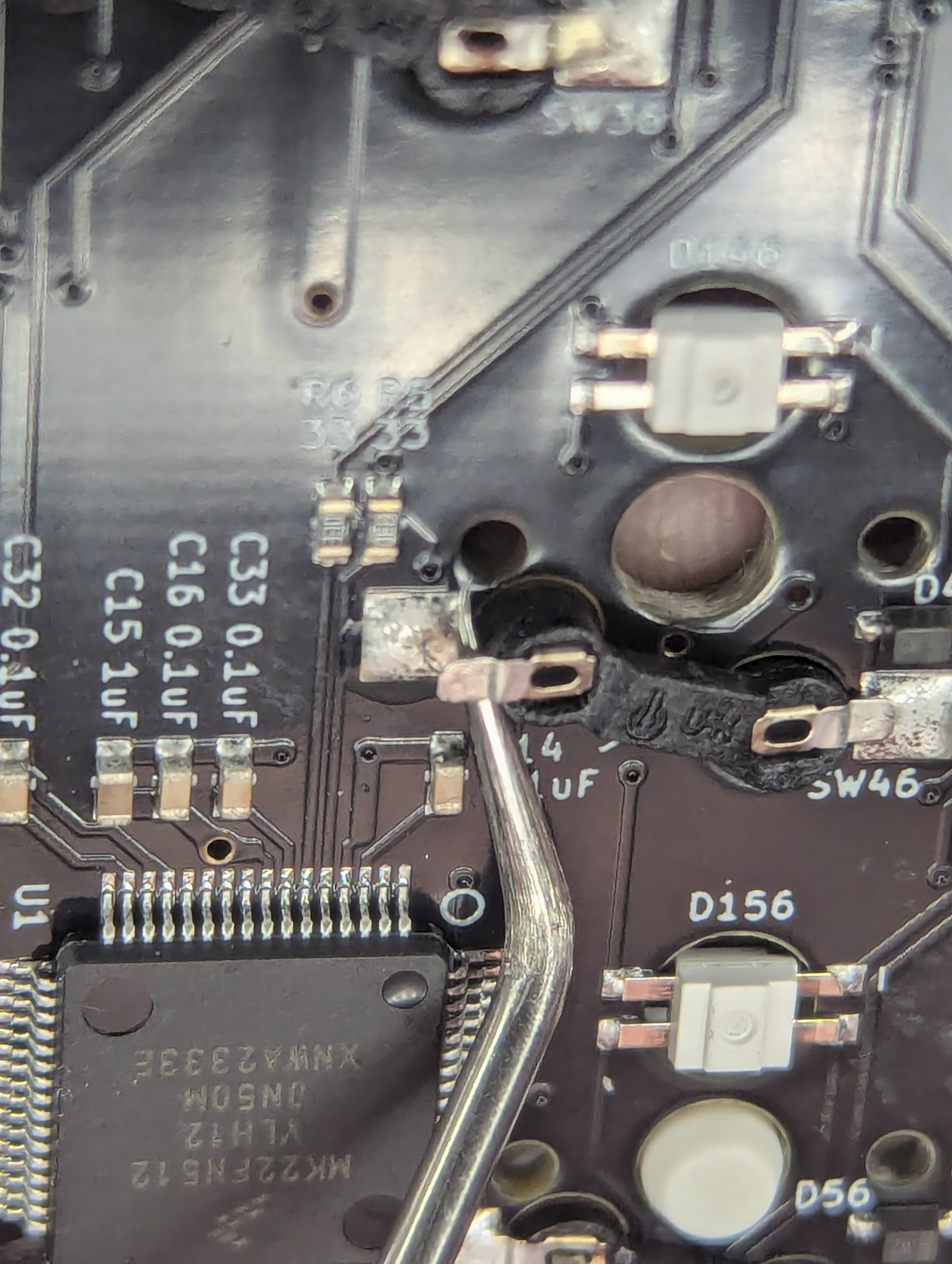

One of the switch’s leg receptacle pincer was drifting away. I ended up taking the board apart and getting a friend better with circuits to look at it. Before failure the key was inconsistent. Looking at the back side ( picture ), the solder is just gone. What was left of it prob came off when I tried to re-seat the switch. Likely the lack of solder what allowed the pincer to “drift”. He also noted the USB was floating instead of being soldered and touched up a few other keys but this was the only one that outright failed. Re-soldering the contacts for the switch socket resolved the issue thankfully ( I suppose this is the curse of lead-free solder ).
TL:DR soldering contacts on the backside resolved the issue.
