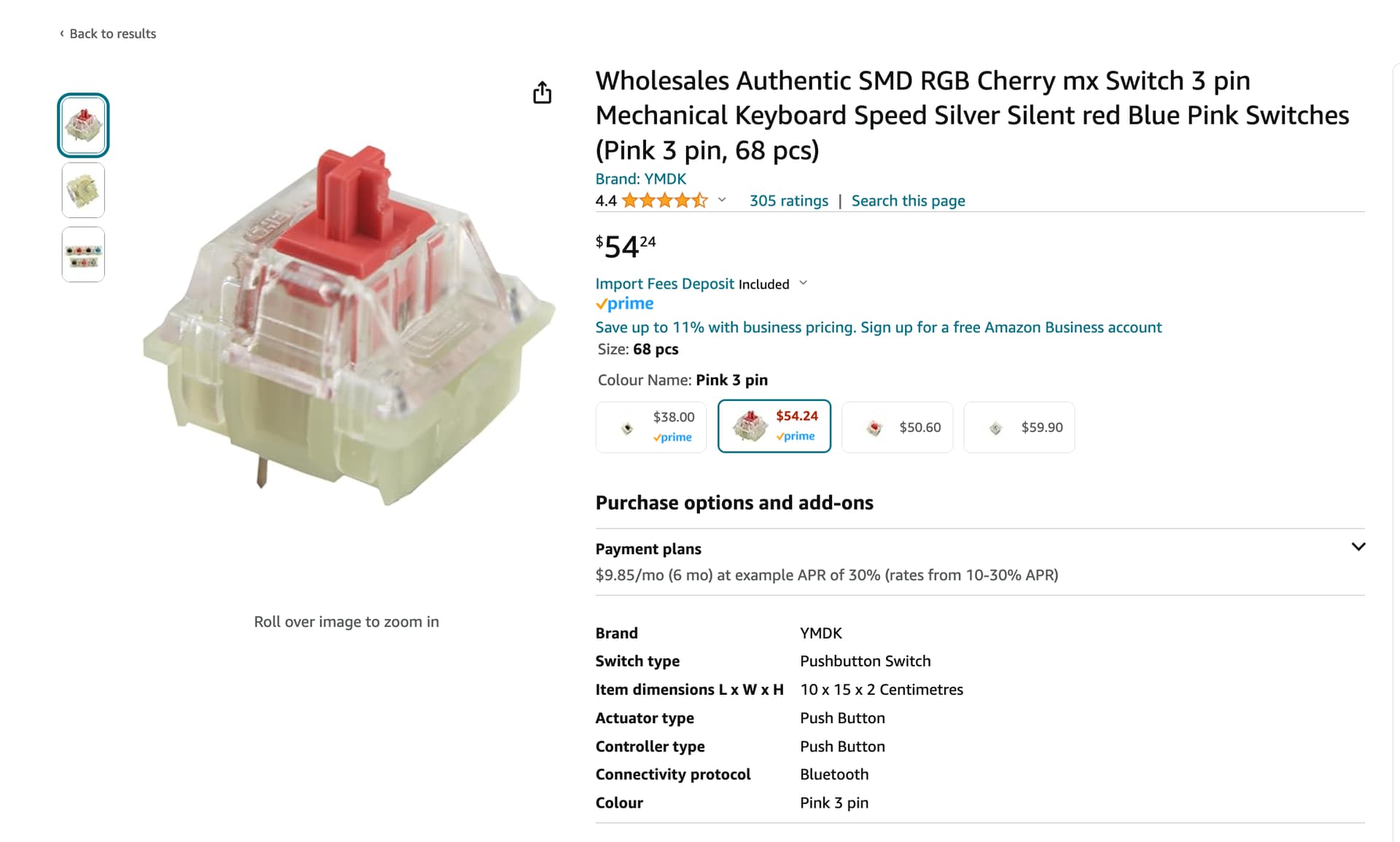

There are options on Amazon for replacing. Please share any experience with non-UHK replacement key switches. Thanks!
Well, there are hundreds of options, and at the end of the day, experience depends on personal taste ¯\(ツ)/¯.
As far as I can tell, above silent red / pink sound as an excelent choice given your requirements.
