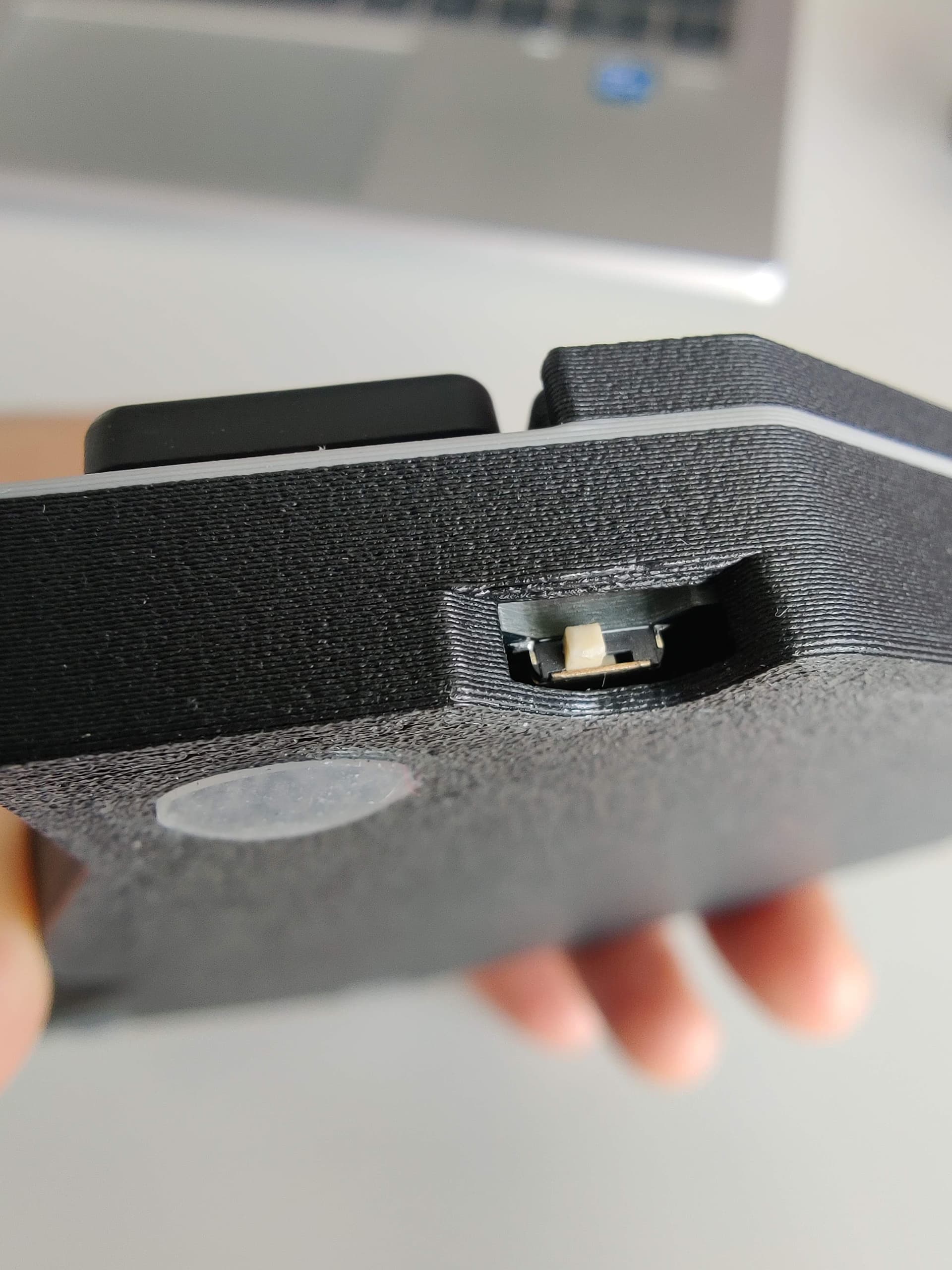

Or include an actual power switch

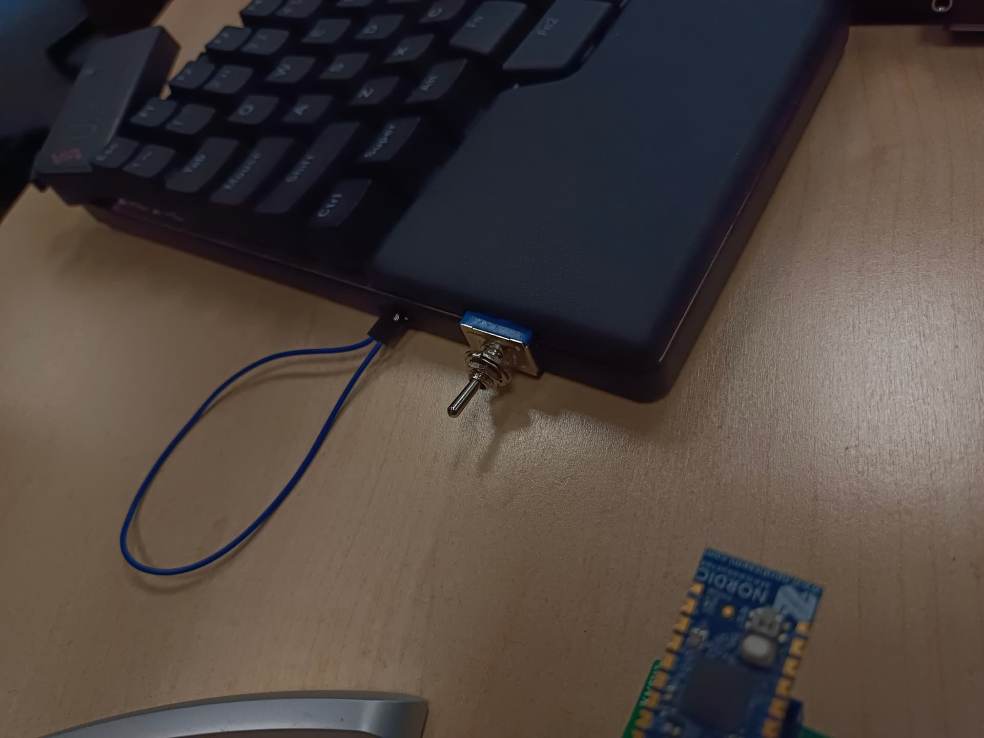

I am using this, and it is super satisfying, although admittedly placing it on the side is inconvenient because of tenting…
Now that’s a BIG switch. Very tactile and clicky. ![]()
Of course, he went with the blue switches…
Screw it, I’m just gonna go ahead and solder some of those into the sockets on my modifier keys.![]()

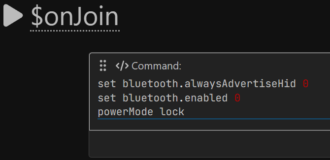

This works perfectly using:
https://github.com/UltimateHackingKeyboard/firmware/actions/runs/15613737585
Here’s my AFUHK Mode:
And of course, just switch to powerMode sleep for AWUHK Mode (Away With UHK
