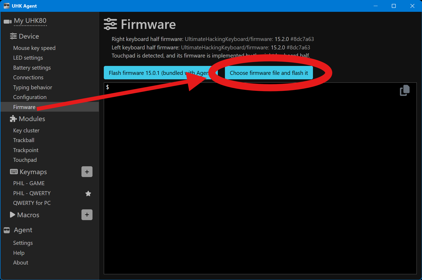

  1. Download the file in the “Assets” section called “uhk-firmware-15.2.0.tar.gz”, but don’t extract it’s contents.
  2. Then open Agent to the “Firmware” tab in the left panel, and in the main panel, click the button that says “Choose firmware file and flash it”.
  3. Then select the file you downloaded in the first step, and click “Open”.
The firmware should then start flashing.
I don’t really know all the details, but I had a discussion with the devs a while back that explained that. IIRC, when it comes to the firmware terminology, the UHK60’s left half is referred to as a module (not to be confused with one of the detachable modules). The UHK80’s FW is a little different though, which is why it has left and right directories.
Anyway, rest assured that FW contains everything for both halves. The flashing process should automatically use what it needs from the “tar.gz” file. No manual extraction necessary. :wink:

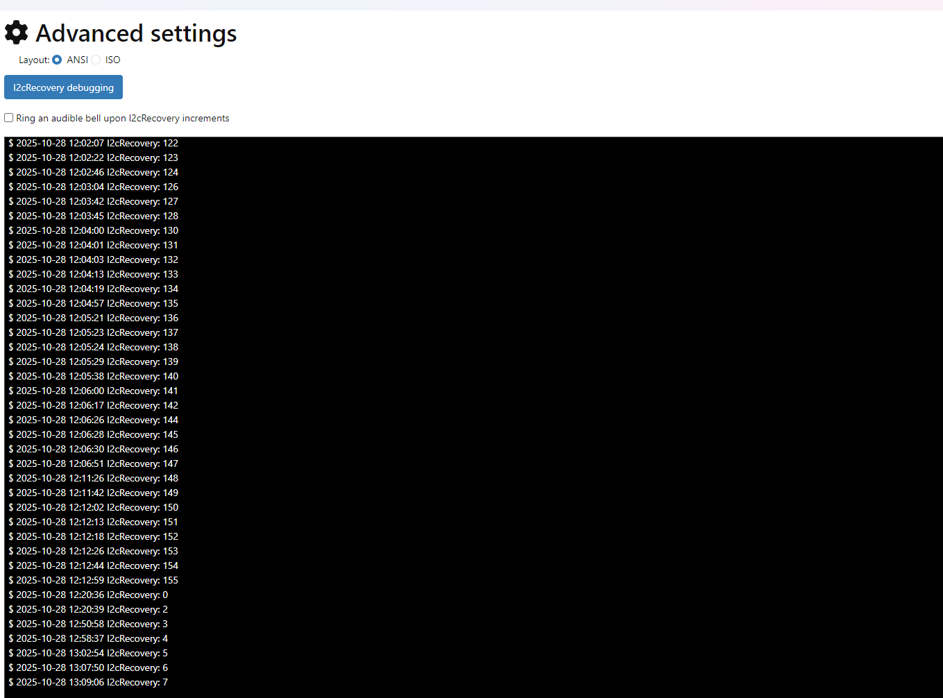

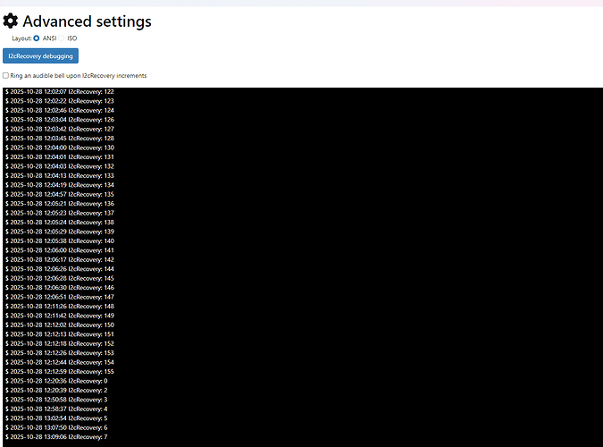

I updated to the latest firmware, and the problem persists. I’ve enabled the advanced debugging, and I see the following:
The number reset after my firmware upgrade (to 15.2).
Is it possible that there’s something loose in my left half? Any anticipation that it could be an easy fix?
