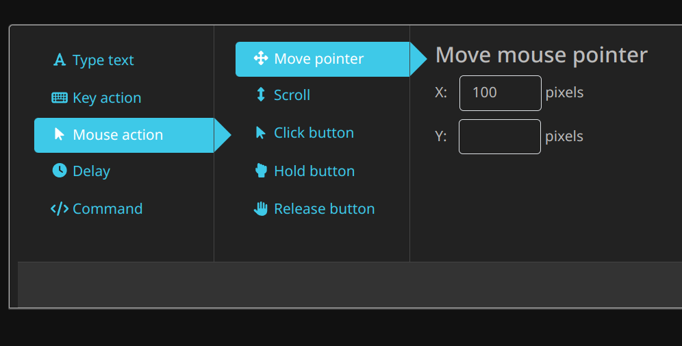

This seems to be what I’m looking for, the problem I’m having is how I replicate the GUI action from the Agent software.
To clarify what I’m looking for here I want the key to act as a mouse key (this macro does that), unless the shift key is held, which should instead make it replicate this functionality from the macro GUI:
So replacing where you wrote <the gui action to jump n pixels> with whatever the actual macro equivalent of the above image is.
Is there a macro command for this, or do I need to call call upon a different macro that I setup with this GUI?
No, you don’t need macro equivalent. You just use the actual thing:
