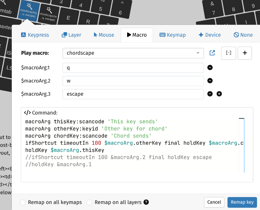

Here is an example:
macroArg thisKey:scancode 'This key sends'
macroArg otherKey:keyid 'Other key for chord'
macroArg chordKey:scancode 'Chord sends'
ifShortcut timeoutIn 100 $macroArg.otherKey final holdKey $macroArg.chordKey
holdKey $macroArg.thisKey
and in current Agent, you configure this as:
A future Agent would show the descriptive labels (ā€˜This key sends’ etc.) instead of $macroArg.1 etc.
