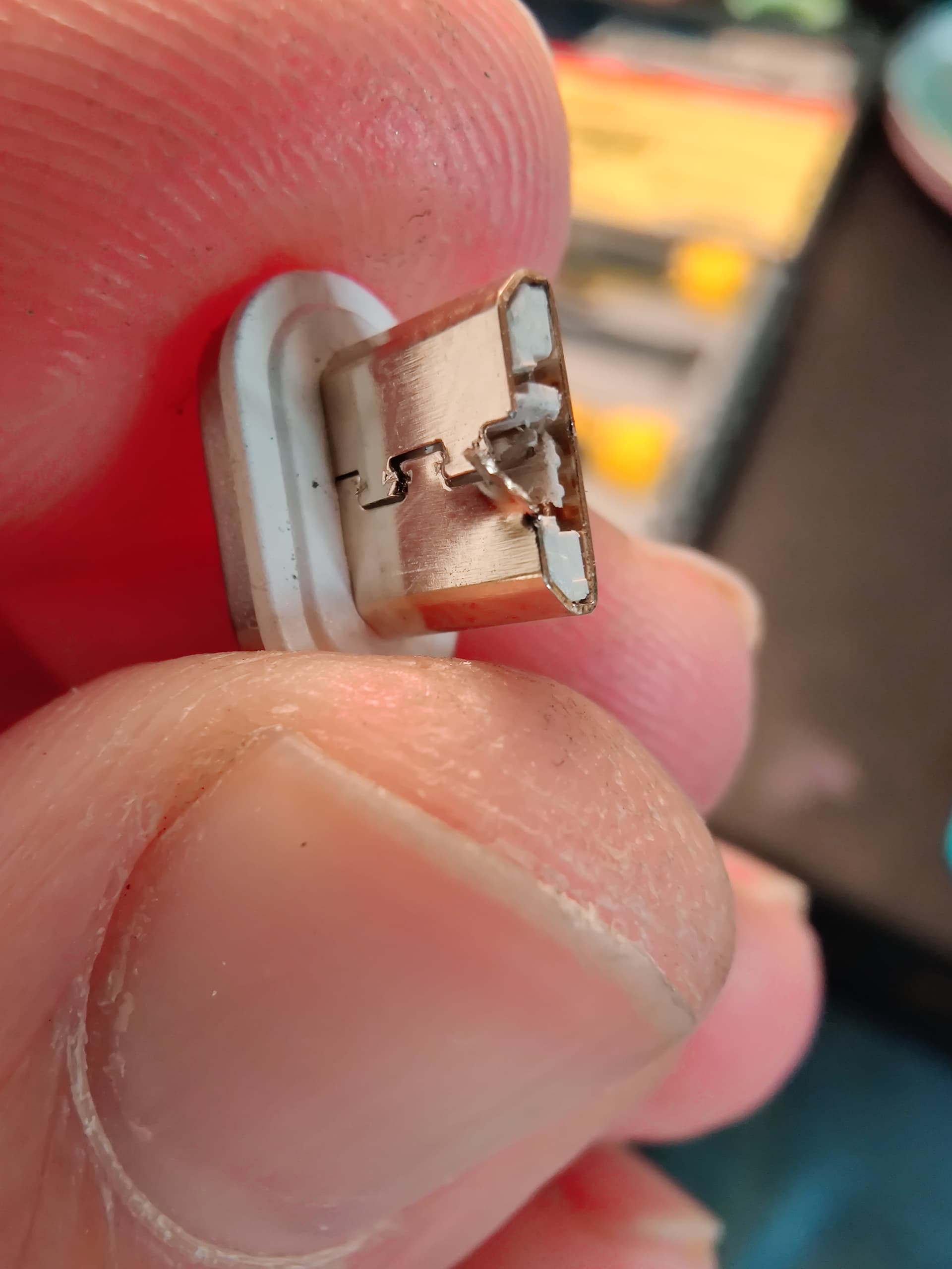

I’ve done it for both v1 and v2. In v1 it was easier to solder to the connector, with USB-C it’s not an option without very solid soldering skills.
For the start, I am using NetDot Gen10 micro USB cables. It’s not an advertisement, you are free to use whatever fits you
In the beginning, we should disassemble the connector and free the pins. To get cables on them, I use a fire and a needle. Then just push the pin into the cable’s tiny hole
