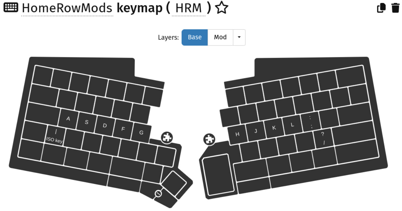

To keep it modular, I have moved the home row keys onto a separate keymap (HRM) which is used to overlay my regular keymap.
The base layer contains regular key mappings without mod functionality.

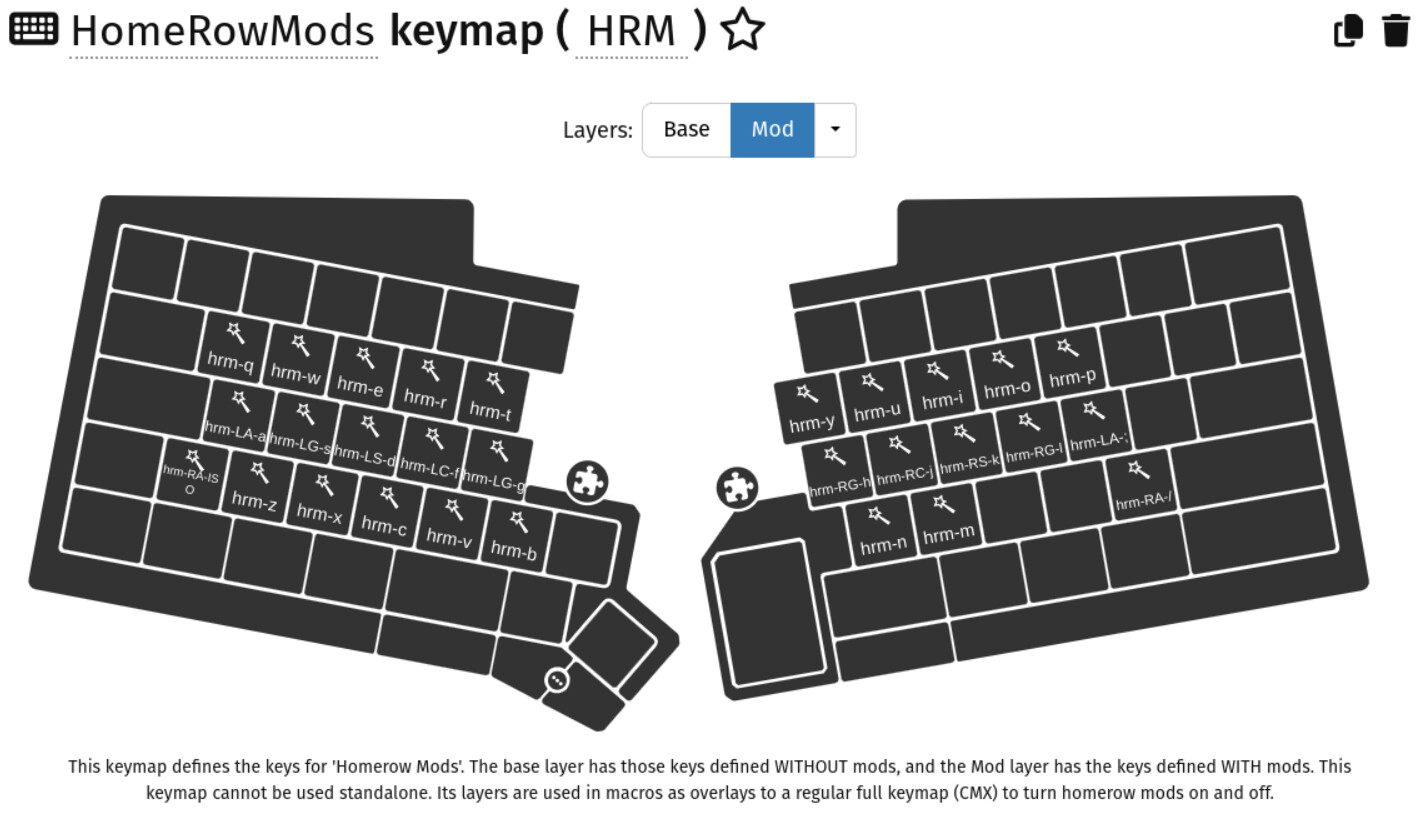

The mod layer maps home-row-mod macros onto each of the home row keys.
My home row mappings are:

Each of the homerow keys now has a macro like this:
hrm-LS-d:
if ($hrm_active > 0) ifSecondary final holdKey leftShift
setVar hrm_tick 0
holdKey d
Adapt holdKey leftShift and holdKey d for each of the keys.

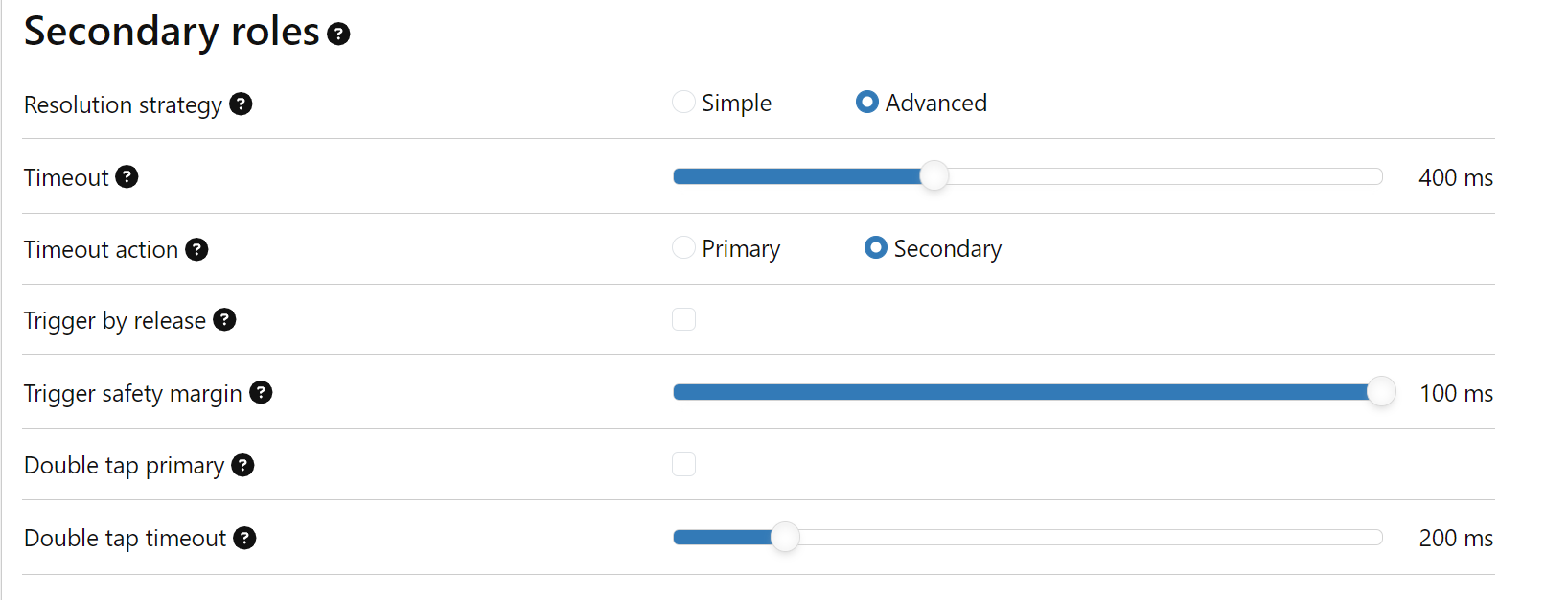

First, the regular secondary mode configuration of UHK applies. This is what I use; I set it in $onInit:
set keystrokeDelay 10
set secondaryRole.defaultStrategy advanced
set secondaryRole.advanced.timeout 250
set secondaryRole.advanced.timeoutAction secondary
set secondaryRole.advanced.triggerByRelease 1
set secondaryRole.advanced.safetyMargin +5
