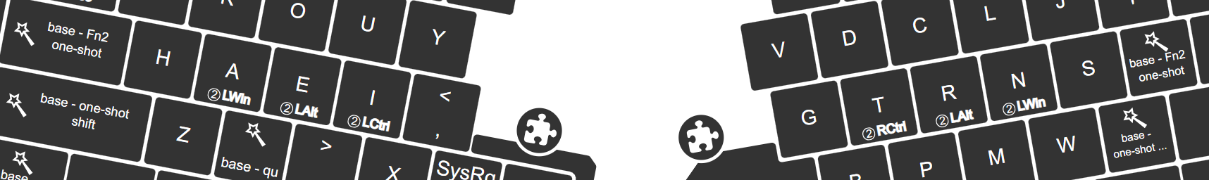

Not exactly Miryoku, but I’ve been experimenting with Home Row mods.
As for secondary role timings, I use these (in my $oninit macro):
set secondaryRole.defaultStrategy advanced
set secondaryRole.advanced.timeout 250
set secondaryRole.advanced.timeoutAction secondary
set secondaryRole.advanced.triggerByRelease 1
// positive values for savetyMargin favour primary role, negative favour secondary role
set secondaryRole.advanced.safetyMargin +5
The reason why I have the mods on those keys (and not where Miryoku has them) is because my “maxtend” layer has Alt/Shift/Control already on those positions:
Also I use a Colemak keymap (on the host) and thus they are on the keys labeled A (for Alt), S (for Shift), and T (for conTrol) ![]()

The best I have for you is my Github repository “maxtend”. Read the Background section. The screenshots in the UHK chapter are from an older version of Agent; they don’t show where I now have layer switches and macros, but it should give you a general idea how I’ve configured things. One of these days I need to redo that whole section with updated explanations and refreshed screenshots.
