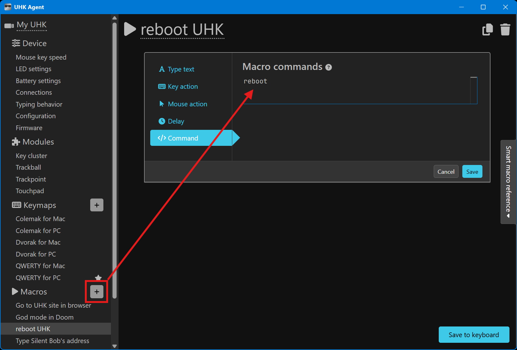

In the meantime, could you try using the reboot macro to see if that also resolves it? Hopefully that works as well, so you don’t have to fiddle with the cable when it happens.

You can create a new macro in Agent’s left panel, and then type reboot into the macro command entry field:
Then map it to a free key:
reboot macro restores the behavior.
