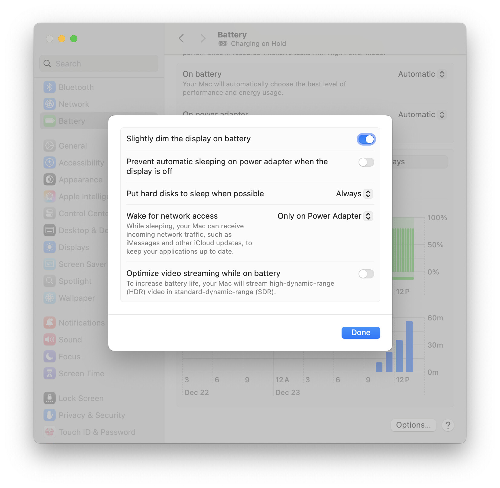

- I use uhk60v2 with key cluster and trackball module, and the firmware is 12.0.1.
- Set the macos power settings to match the attached screenshot.
- Put the mac into sleep mode by: 1. Press power button to put the mac into sleep mode. 2. Press esc key to turn off the screen protector.
- Wait for several minutes for the keyboard light to be turned off. In my case, it took about 1~2 minutes. I think it’s 100 seconds but not sure.
- In this state, pressing the macbook’s key or other peripheral to wake up the mac result to normal behavior - the uhk also wakes up and works without error. However, if you press the key on the uhk or move the trackball, the mac wakes up but the uhk doesn’t fully wake up (no keys or trackball response, led & rgb doesn’t turn on).
I have followed this step and reproduced the issue three times out of three attempts.
