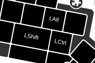

At first, I came up with the following key arrangement which worked reasonably well. I could make any combination of those three keys with my left thumb only.
I could do a similar thing with the right thumb, only this is still pretty awkward, and I needed that thumb to use the mouse, potentially while holding mods. I had to find something even better!

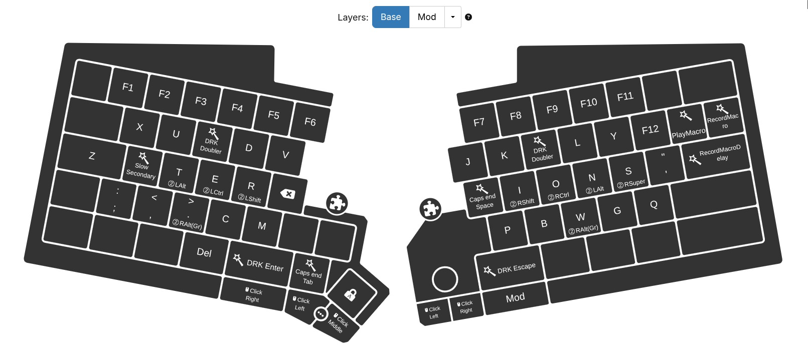

Describing the resulting layout
The result can be seen on Yuzu, or in the config, or in the images below

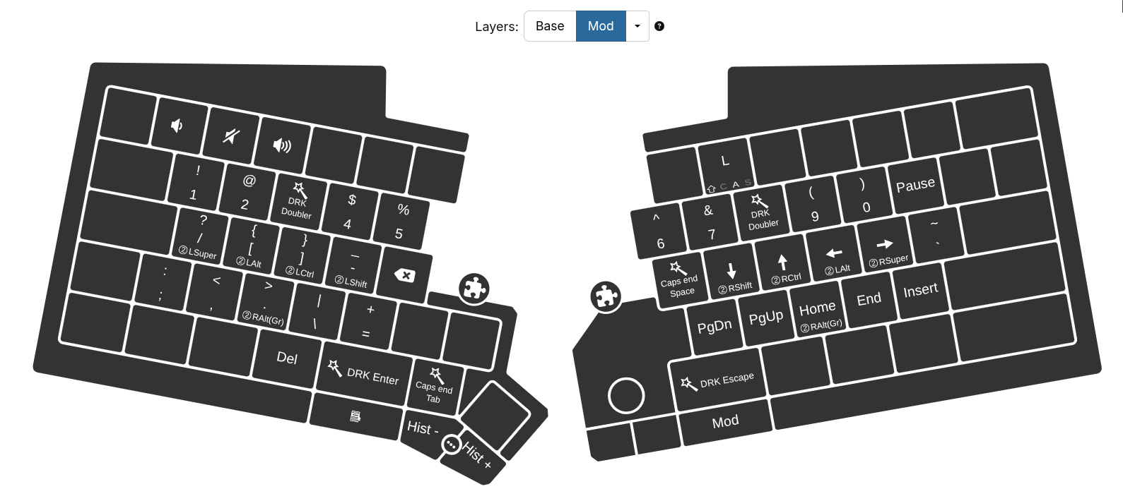

I have thankfully managed to keep all of the main keys within my comfortable zone. F1-12 are on stretch keys, but they aren’t used in typing, so I can live with stretching for them when I need them.
I was surprised to find that I could actually fit all of the keys within the comfortable keys on just two layers, with keys to spare. I used the leftover keys to duplicate keys from the main layer on the secondary layer. These are keys which are commonly used when typing number sequences (punctuation, space, enter, tab, backspace, delete). This is to avoid too much mod-dancing while typing numbers.
The locations of space, backspace, enter, tab, escape and delete are somewhat arbitrary. I placed space and backspace when I was still playing with the thumb mod idea, and then they got kinda stuck. I guess they would technically be better placed on thumbs according to most people’s preferences, but I actually find not using my thumbs for taps while typing more comfortable. I find the comfy keys on my not-thumbs more comfortable to use than the thumbs for taps.
Using HRMs, I have made all mods available on both hands so that any key combination can be made comfortably without any stretching. On the flip side, HRMs come with two disadvantages:
  • False activations of the unintended role. This has been largely solved with the recent additions to the firmware in that area. Most people should be able to find some combination of the available parameters which enables them to type reliably without false activations.
  • Typing in all-caps is annoying as one needs to change which hand holds Shift all the time. However, it turns out that the ancients before us had a solution to that already: Caps Lock is at a reachable location, and is then disabled through macros on Space, Enter and Tab, as well as via Escape. So when I need to type a word in all-caps, I just hit Caps Lock, type the word and on space, it’s disabled automatically.
The location of the HRMs could be switched, and in hindsight, I think I should have put shift on the middle finger instead of the index, but there’s no way I’m relearning that now!

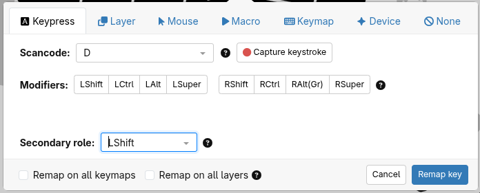

If someone could find the time to whip up a very basic userConfig with all the necessary settings (esp. typing behavior stuff) and a simple keymap/layer template, I’d love to try it :pleading_face:. (A dumbed-down tutorial wouldn’t hurt either.) I’m sure it would be easier for me to wrap my head around it if I could see everything mapped out in Agent. If I have to read through the docs first, I’m gonna give up before I even start :sweat_smile:.
Well, I would recommend the settings from the User Guide, more or less.
set secondaryRole.defaultStrategy advanced
set secondaryRole.advanced.triggeringEvent release
set secondaryRole.advanced.timeout 300
set secondaryRole.advanced.timeoutAction secondary
set secondaryRole.advanced.doubletapToPrimary 1
set secondaryRole.advanced.safetyMargin -50
set secondaryRole.advanced.triggerByMouse 1
set secondaryRole.advanced.minimumHoldTime 130
set secondaryRole.advanced.acceptTriggersFromSameHalf 0
Then just add secondary role Shift on your home row middle fingers, or index fingers, and you should be off to the races. If you tap the key, it’s the normal key, but if you hold it while pressing another button, it’s a shift key. If you don’t like it, you can remove it again.
You need to do it on the same finger on either hand, and with the above settings, the keys will only work as shifts key for keys from the other half of the keyboard.

Does this mean that if I have LShift secondary role on d, that holding d and tapping f on same half should not produce F? Because it shifts to uppercase for me regardless of set secondaryRole.advanced.acceptTriggersFromSameHalf true or false.
I’m on UHK80 with release FW v16.1.1.
I suspect, then, that you held the key for a while first, or that you have already typed another letter which turned the key into a shift.
When you press a dual role key, it waits to see if it should become a primary, in your case D, or a secondary, in your case lShift.
With the settings above, it will turn into a shift if it held for more than 300ms (timeout), or if another key is pressed and released while holding the key.
Once the key is either primary or secondary, it will stay that way until release. This means that even when ignoring same half for triggering, for instance, once it has been triggered as secondary, it will still be a shift key for keys on the same half.
That is the basic premise. The configuration options are parameters which can be tuned to match your typing style to allow you to reduce the number of times that the key became the other role that you intended.
I think in your case, if you were testing the feature, you might have run into the timeout and it becamelShift. You can increase timeout if this is undesired. I have a PR open for adding another option to make timeouts more advanced, including the possibility of effectively disabling it.
